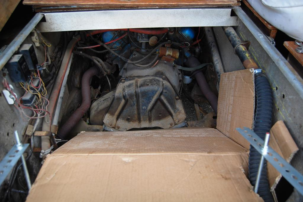

Here is the big old 455 in the back and note the radiator is behind the power-plant and all that heat too.
My 455 Tornado power-plant. Still not 100% sure what year it is.
New Flex-a-Lite radiator and fan installed. (Taken in 2014)
Mocking up a doghouse, that I built, in front of the radiator to keep the engine heat away from passing through the radiator. (Done in 2014)
