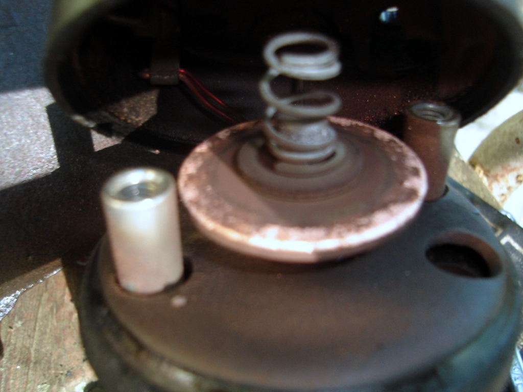

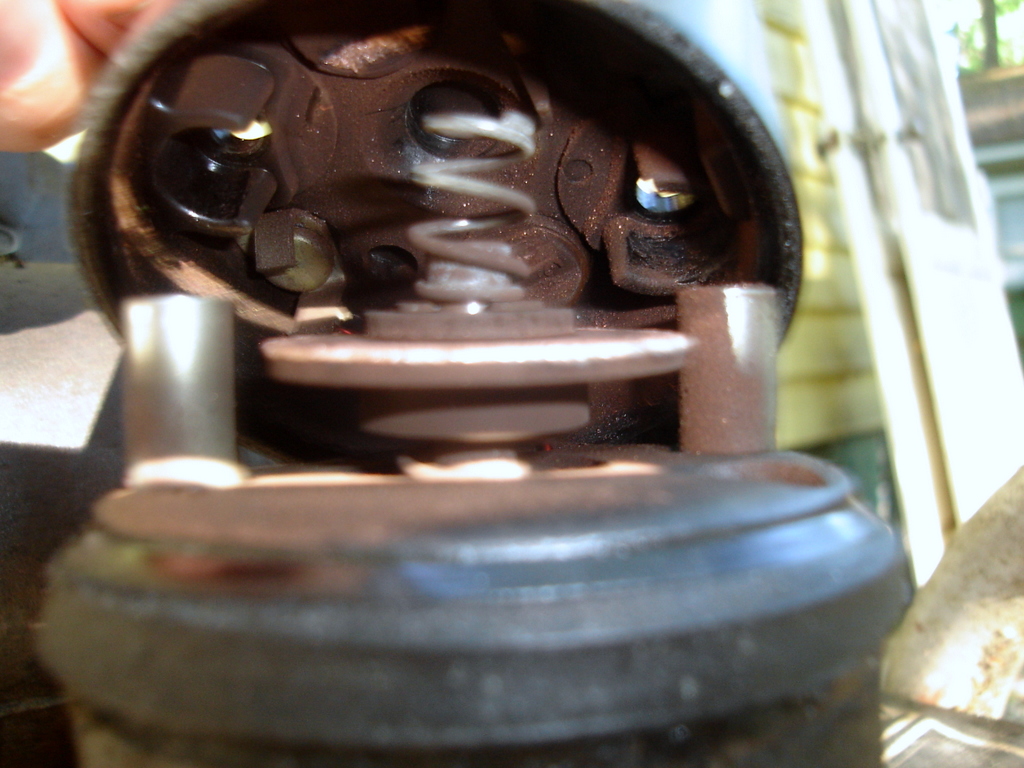

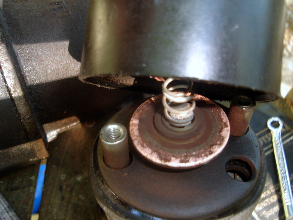

Here are some bad pictures of my solenoid. I took it apart, cleaned everything, wire brushed the little contact disc and put it in upside down so the clean side could get some use.

Postby Otto Skorzeny » Thu Aug 30, 2018 2:20 pm
More pictures as I found the solenoid.
Re: Hello from Germany!
Postby Otto Skorzeny » Thu Aug 30, 2018 2:22 pm
Here's the disc after I cleaned it up.

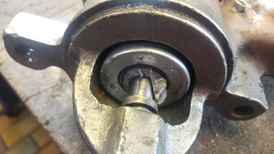

Well a replacement bendix should take care of it, probably a universal part. I
wonder what country made that one?
The flexplate for the 66-67 Toro had a very bad reputation with gear teeth
wear. Better check out yours. After that they made a special one for Toro
with longer teeth to handle the stress. I managed to find enough of them
for all my cars. Unfortunately it won't interchange with the 425 flex plate.
