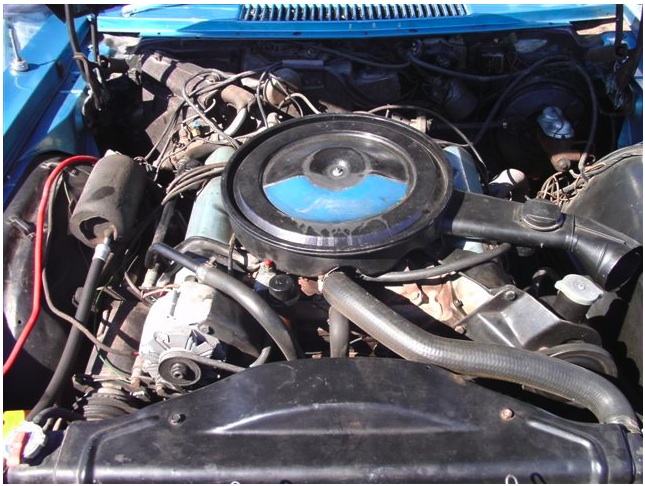

Perhaps a silly question, but will throw it out here. I've been looking at a '67 on-line that is currently for sale. The seller tells me that the engine is original to the car, but I'm rather skeptical because of the photo below. I've never seen a '66 or '67 that didn't have the dual-snorkel air cleaner housing. It is most likely a motor from a 68-70, but wondering if there's any chance at all that some late-build 67s might have an engine like this? If I get one of these cars, I want one that is as close as possible to the model-year standard. Any insight appreciated.

Well, im not an expert, but that looks like the appropriate engine. The oil-fill tube looks just like my '66, and the color is usually a good tipoff unless it has been painted. Toro's were the only car to have a slate blue engine. That being said, that aircleaner is from a much later model small block. Looks just like the one on my 82 el camino.

Unsure about casting#s until I dig out a 67 service manual but it looks like a 425 but a 2nd gen air cleaner.

All 66 and 67 Oldsmobile 425 V-8 can be identified by an engine unit number that stamped on a machined pad on the front of the RH cylinder head (behind the alternator). A Toronado engine should begin with a single letter prefix (ident the basic engine displacement), followed by unit number and a further letter (ident for a special high performance version)
Should be then:
1966 and 1967 - N (unit number) T
The 425 block casting number is located at the front of the block, between the intake manifold and the timing chain cover.
1966 to 1967 - 389244
Casting number of 1966 cylinder head is located just below the valve cover in the middle of the head on the exhaust outlet.
Should be 1966 - 389359 or 1967 - 394548
From 1968 till 1976 the 455 Toronado engine unit numbers are stamped onto the oil fill tube (should not used for identification because it is easily switched!).
1968 - US or UT
1969 - US, UT, UV or UW
1970 - US, UT, UV or UW
The block casting number (much better for ident) is located at the front of the block, between the intake manifold and the timing chain cover.
1968 to 1976 - 396021
Casting number of 1968 cylinder head is located just below the valve cover in the middle of the head on the exhaust outlet.
1968 to 1969 - 394548
1970 - 403686 or (W30 only) 404438
Hope it helps
