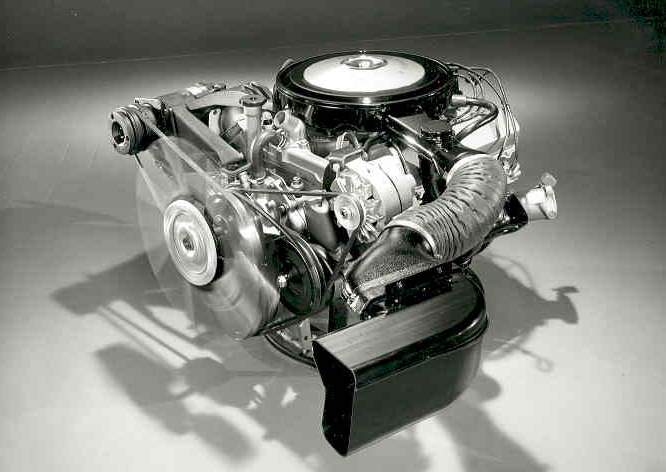

Yes !! starting with photos of the whole car plus interior, then photos of the body plate, VIN as well as the transmission ID plate, check trans case for VIN, (see photo) pick up the washer bottle and all of the pieces related to the out side air (Keep in mind there is a air horn under the fender) see photo, also if still there the radiator as well, there is an all important thermal vacuum switch on the drivers side end (see photo) ... include in this all of the vacuum hoses associated to that switch.

It is! this is part and parcel of the W34 cold (fresh) air intake the hole is stamped out to receive the under fender duct shown in BW photo above description = 68-W34-OAI.jpg. Its design is to pick up the cooler outside air in front of the radiator rather than the use the warmer / hot turbulent engine compartment air. It was never designed/intended to be a ram air system. The automatic vacuum head light doors did as much or more in the way performance by providing better temperature management .... none the less it helped provide lots of go for a mere $49!
