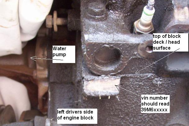

Well, at least these old cars don't have to worry about having the VIN stamped into the engine blocks :P So as long as you get an engine from the same year as yours, no-one will be the wiser as to weather or not it is the original engine... unless they read this forum I guess :P But, 'long as the numbers match, don't think it matters.
69W34
Posts: 221
Re: Had a bad day yesterday...
Postby 69W34 » Sat Aug 11, 2012 8:31 am
Twilight Fenrir wrote:Well, at least these old cars don't have to worry about having the VIN stamped into the engine blocks
W-e-e-l-l-l that's not quite accurate as beginning in 68 olds blocks were stamped with a vin derivative, see photos (sorry bout the large size) :shock:
Eng Vin stamping 68 up.JPG (44.71 KiB) Viewed 17734 times
