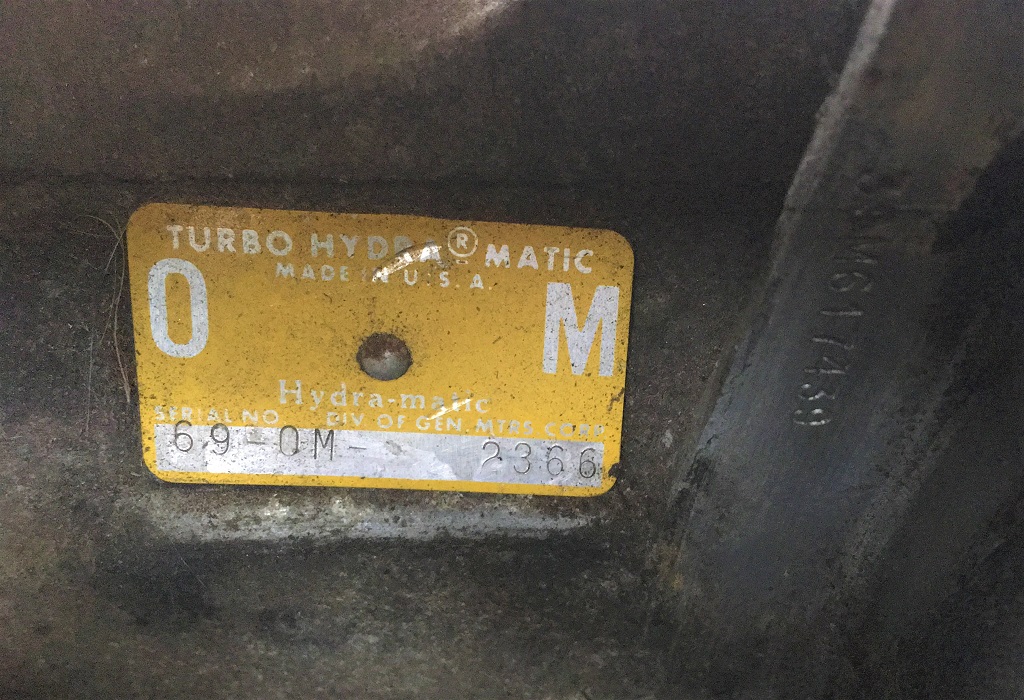

Engine serial no: 39M617439
Transmission serial no: 69-OM-2366 & 39M617439
VIN no: 394879M617439

- DSCF6382.JPG (360.08 KiB) Viewed 16445 times
- IMG_E3191_Dash.jpg (282.35 KiB) Viewed 16445 times
- IMG_3184_OM.jpg (343.08 KiB) Viewed 16445 times
