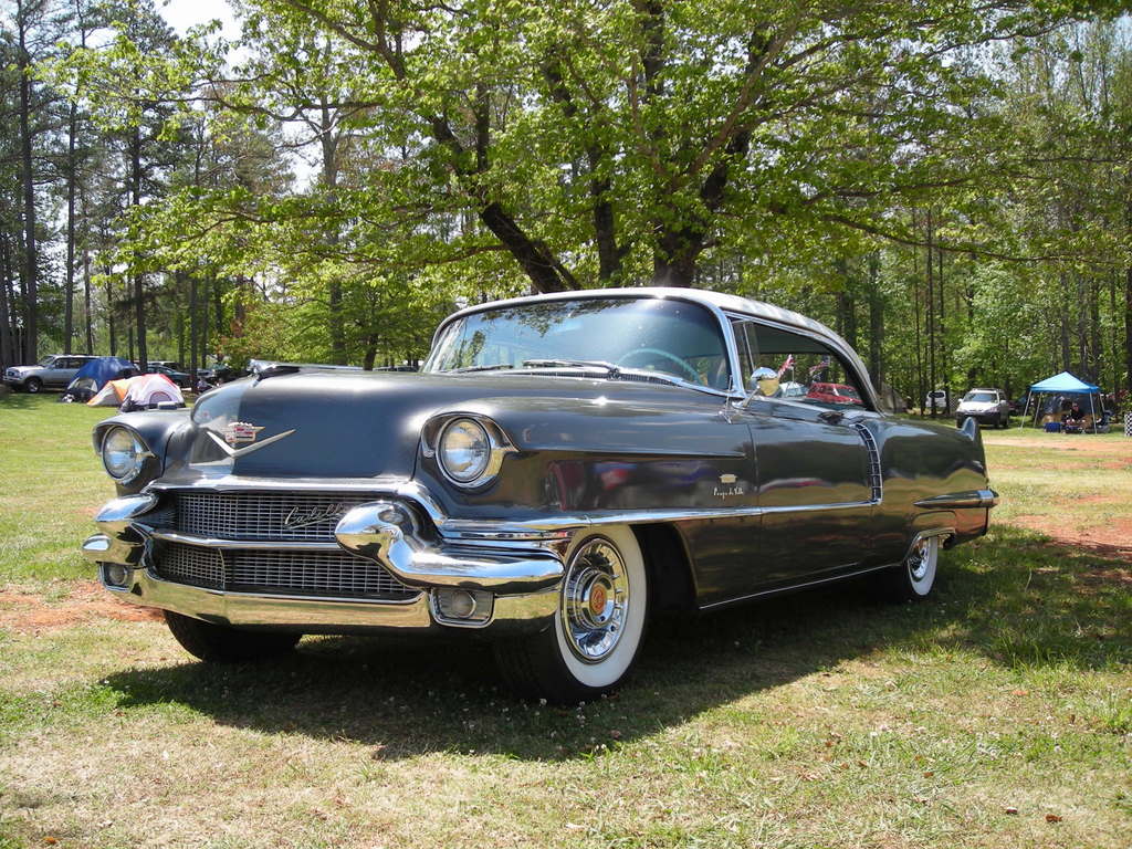

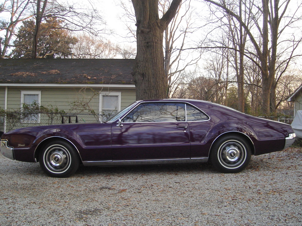

Here's my car. Now you can see what yours would like in Dubonnet. It was the color that sold me the car. It is a daily driver that shares duty with my other DD, a 1956 Coupe de Ville. I don't own a modern car.
I think you should paint/powder the wheels in argent/grey and use trim rings and center caps. They look great and remind me of my all time favorite wheel/cap treatment, the Chevy and Corvette Rally Wheel.
I painted the entire undercarriage of my Cadillac with Rustoleum Semi-Gloss Black. It took 12 cans. I did that in 2007 and it still looks like new. This is a car that gets driven all the time and is not babied. That Rustoleum is great stuff.

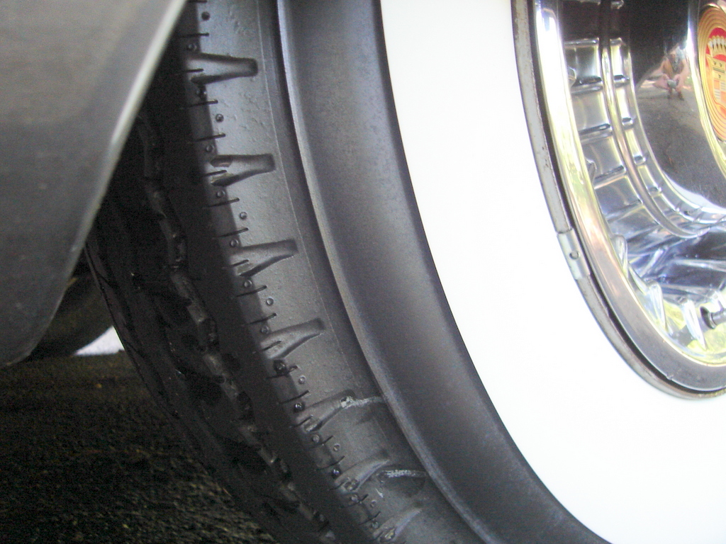

What tires do I have on my Cadillac now? Diamondback radials. Diamondback will be able to manufacture those triple red line tires in your photo. They take virtually any modern radial tire you want and "erase" the sidewall and vulcanize new whitewalls or redline sidewalls onto the tire.
The tires in the photos below are Yokohama 700R radials that look like bias plies from the 50s. They are the absolute best tires I have ever had on this car.
If the tires you want are not in DB's catalog, call them and they will make whatever you want.
They're expensive but you will not be disappointed.

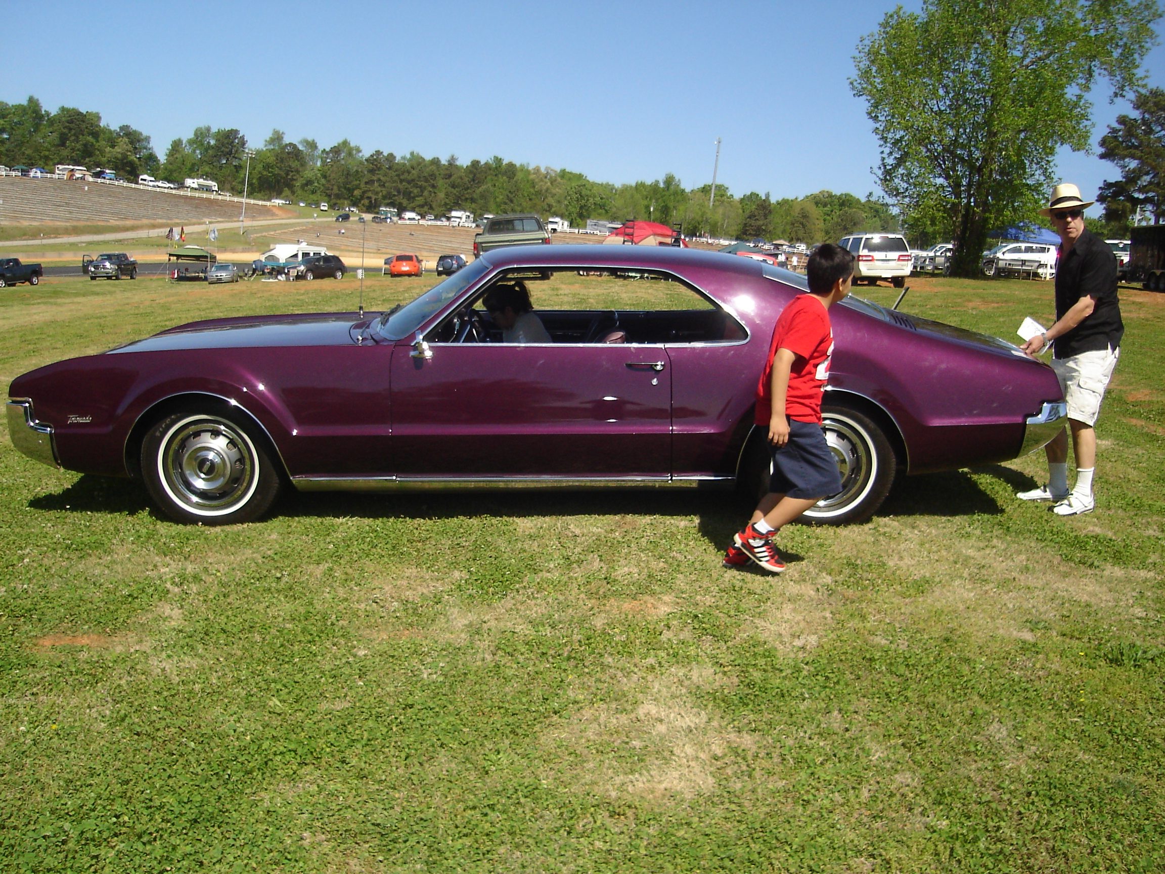

Regarding the back panel, yes, they should be painted body color. These are actually aluminum inserts that are painted body color and glued to the huge diecast back panel. If you think yours is rough, try dealing with the egg crate ones from 67!
To see some pictures of a 67 and 69 Toro, go to this FB site. My car is the 67. https://www.facebook.com/PerfectShapeCustoms

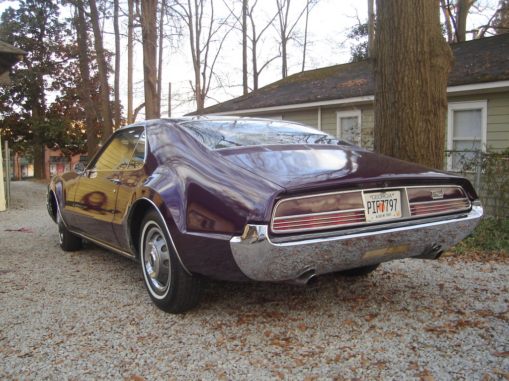

Regarding the rear tail light panel: Any good paint shop should be able to match your body color with a scanner in order to mix up a pint or so of paint for the panel.
I think you'll be happier with a body colored panel rather than with a black one.
