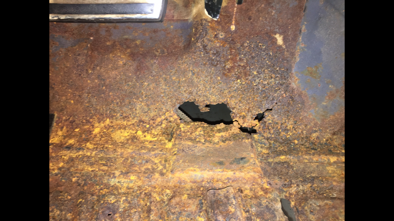

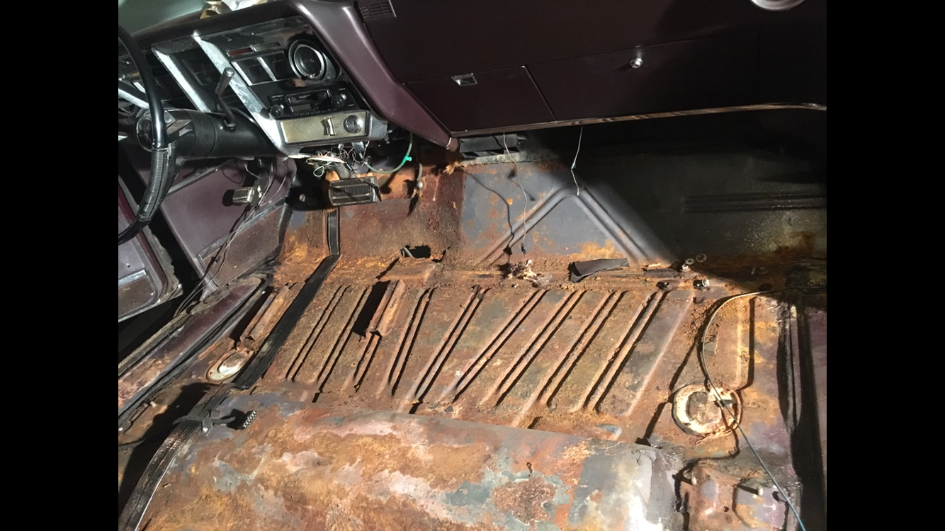

This afternoon I pulled the front seat and the foot pan under the mat in the driver's footwell. I found some minor pinholes here and there, and the driver's toe board is the worst - in particular the area where the base of the gas pedal mounts. I thought the floors were solid - turns out a little work needs to be done. I will snap a few pics later.
Next order of business is to wire wheel the topside of the floors and assess the damage. Once some fresh metal is welded in I will probably use some type of rust converter prior to getting new sound/hear insulation and carpeting.

Thanks Otto - I will check that out. I snuck into the garage a bit ago and found the rust is a bit worse that I had thought. Hole around where the gas pedal mounts, and the floor is rusted thru above the rear support channel. Here are some pics. I have to get my welding buddies over here or bring my car to them...

I would also check your front windsheld to be sure it's sealed properly and not leaking. If they are original, they develop leaks and that goes down through the cowl (rusting cowl) and into wiring, etc. on dash. That may have been the source of the water for rusting there.

Thanks Doc. I think the PO had some repairs done around the windshield area and a new windshield weatherstrip installed prior to the repaint. The seal and surrounding metal looks pretty good to me from the outside, but I will get up under the dash and take a look just in case.
I found pine needles and other debris around the base of the gas pedal where the damage occurred. Hopefully the damage all occurred prior to the repairs.
One good thing is the car sat outside for 4 years before I bought it, and I found zero moisture inside the car.
