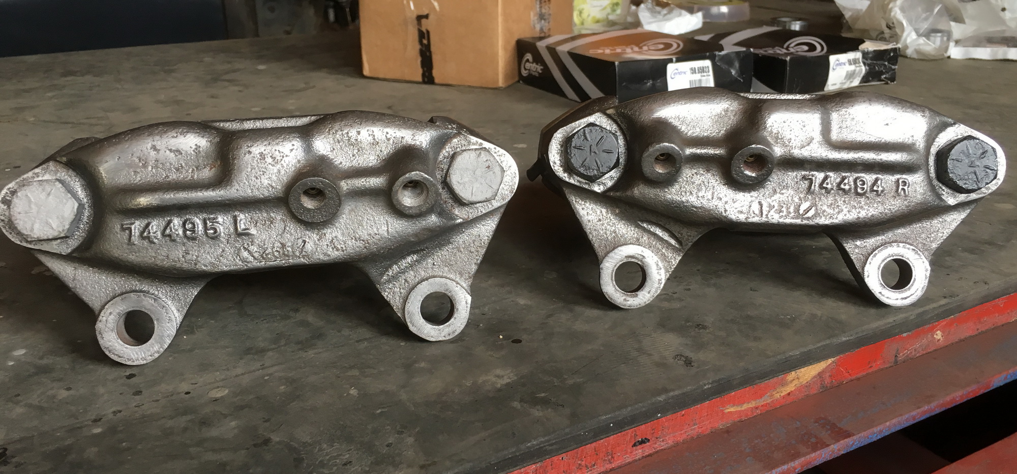

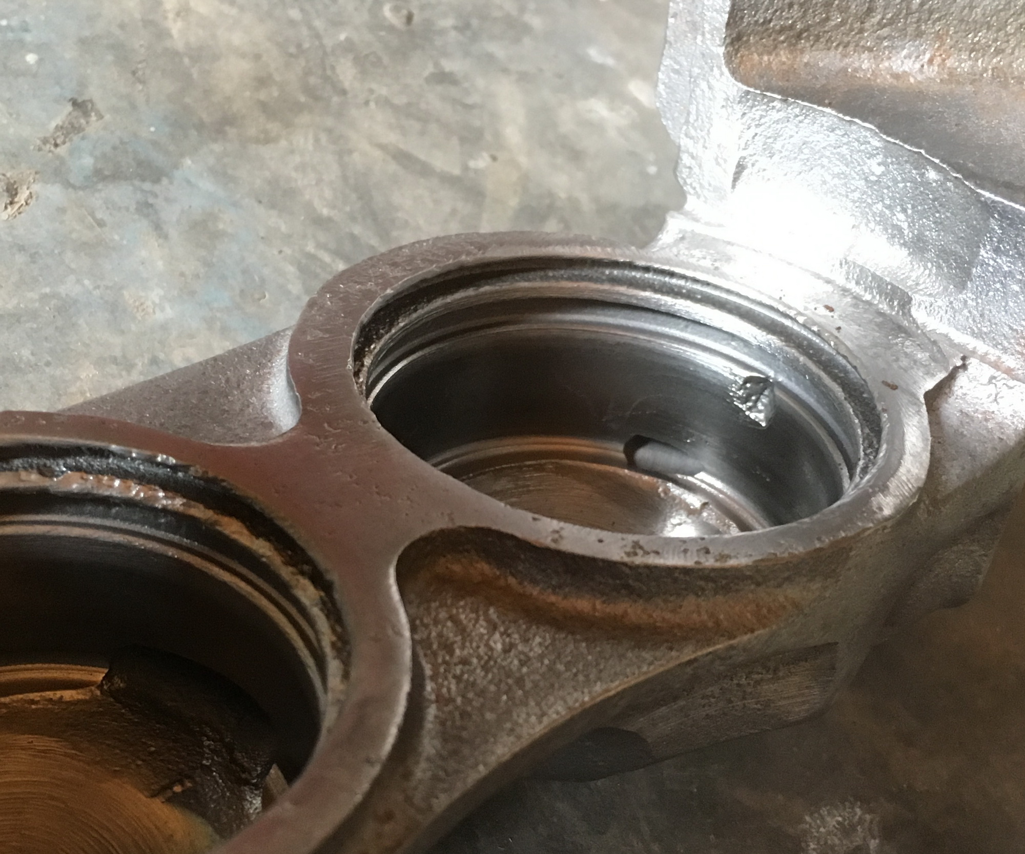

Some more brake work. The calipers cleaned quite well except one bore where a piece of the wall close to the seal is missing. Might still work but isn't that nice at all
- Caliper_5.jpg (747.43 KiB) Viewed 65707 times
- Caliper_4.jpg (656.95 KiB) Viewed 65707 times
- Caliper_2.jpg (642.23 KiB) Viewed 65707 times

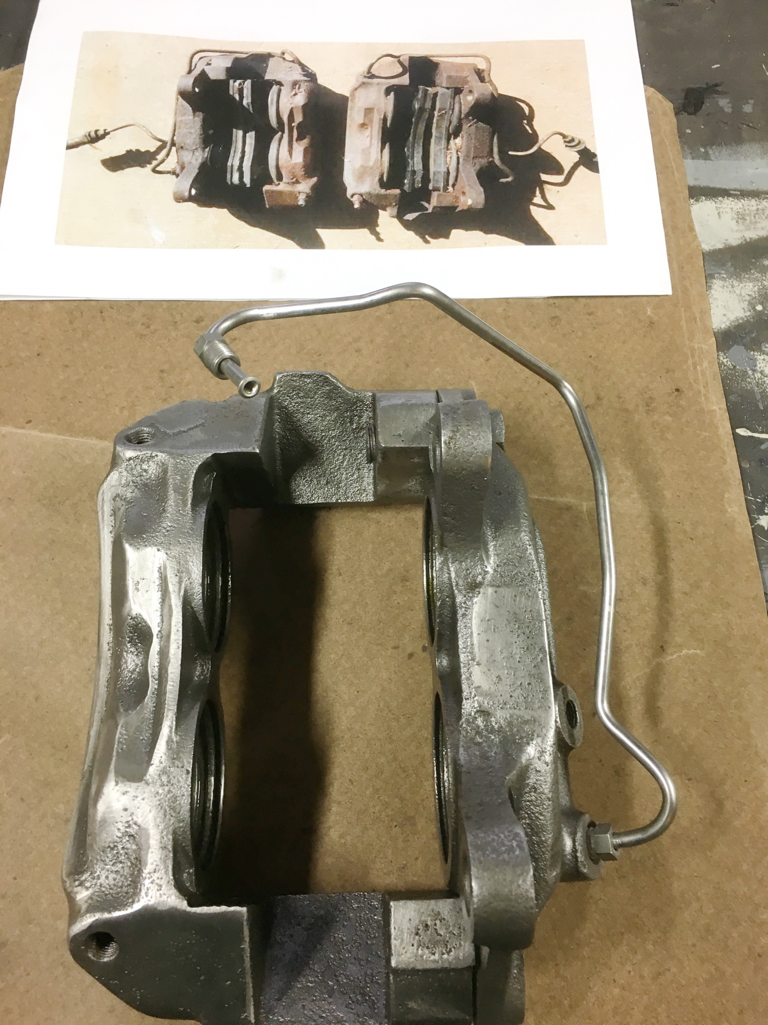

the last set
- caliper_9.jpg (810.11 KiB) Viewed 65707 times
- caliper_8.jpg (811.26 KiB) Viewed 65707 times
- caliper_7.jpg (611.08 KiB) Viewed 65707 times

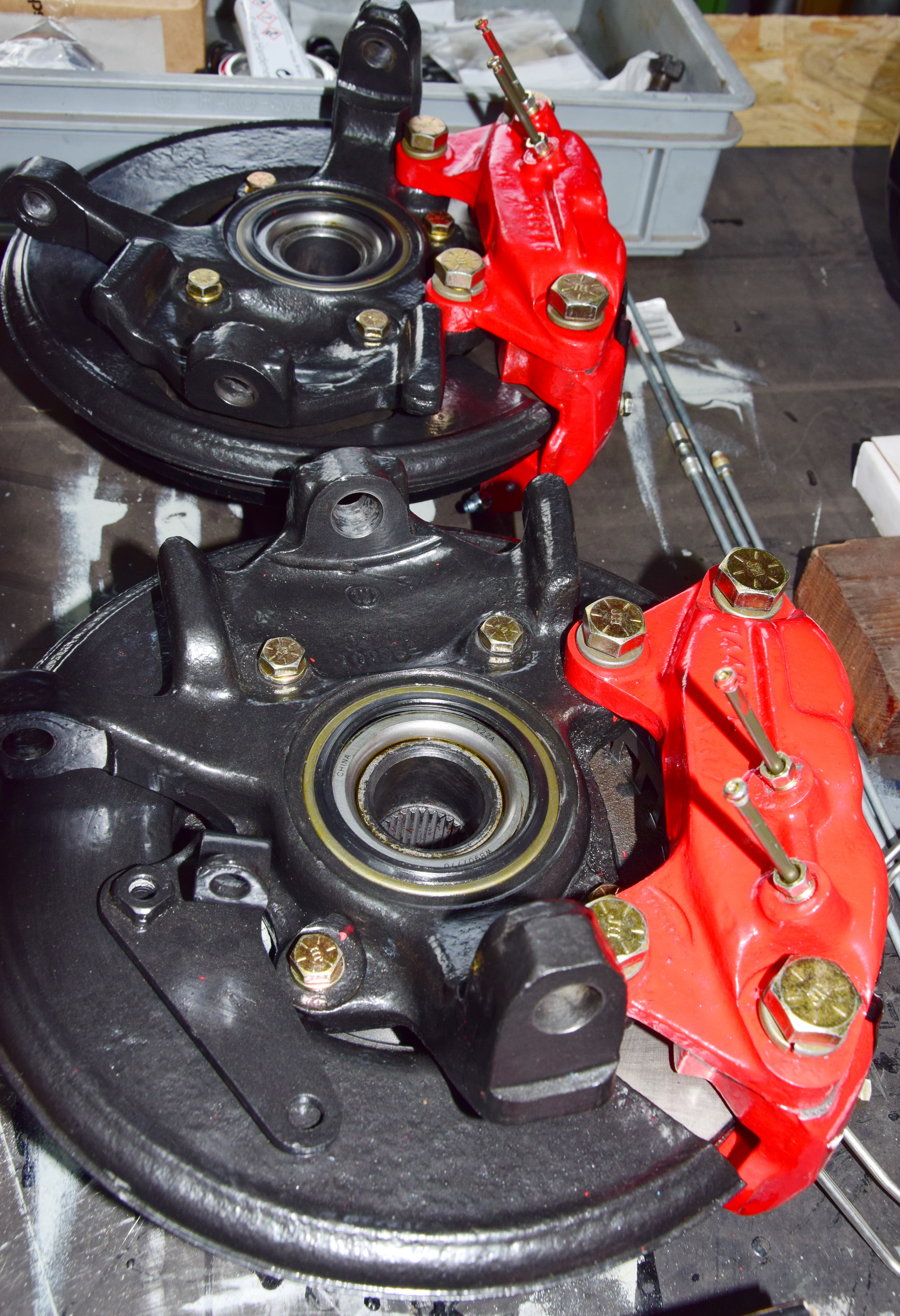

Summary of the 1966 Toronado Front Disc Brake swap:
The calipers are rebuilt as are the steering knuckles with new bearings. The new rotors are in place and look like they were made for this application..
Only things missing are the transfer tubes for the 4 piston Kelsey Hayes calipers. If anyone happens to have some OEM ones and could send them to classic tubes they will use them as a pattern and start building the 1967 Toronade Kelsey Hayes Tubes. As you see on the pics it was quite a way from that pile of rust to the rebuilt components..

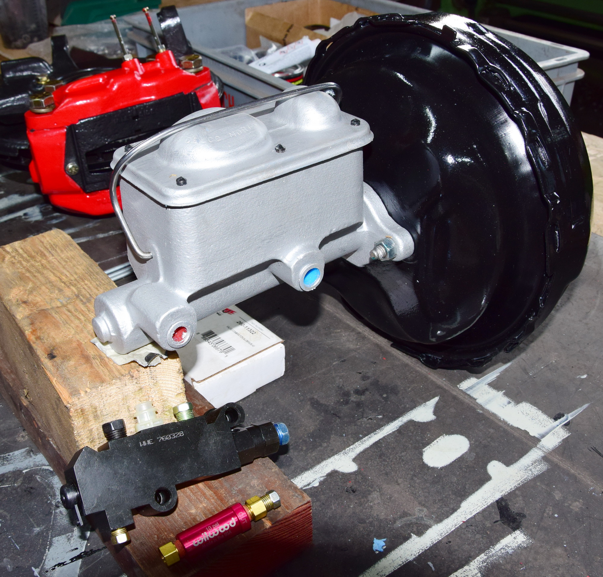

more pics
- valve_1.JPG (1 MiB) Viewed 65362 times
- calipers_3.JPG (1.07 MiB) Viewed 65362 times
- calipers_2.JPG (841.36 KiB) Viewed 65362 times
