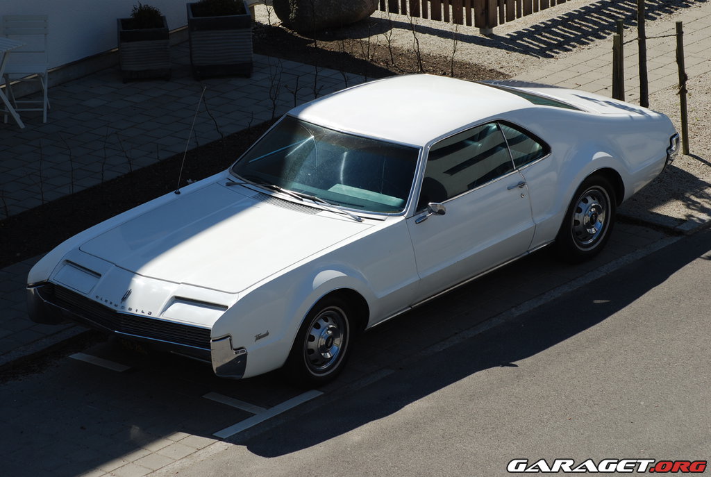

So, after 20 years I own a 1966 Toro, I first sat in one when
I was 16 years old and I knew that one day I will own one.
I have owned tons of american cars, from a 1971 Chevelle SS454
to a 2005 Mustang GT, but my dream has always been a 1966
Toronado (but I love all years of the model but the 66 is something special)
I have searched everywhere for a decent car, my mother in law lives in L.A so
I haved craigslisted and ebayed for Toros since forever, I have even written letter to owners
of such cars in Sweden asking them to sell it to me with no luck....
But a couple of weeks ago i found a 1966 wich haved lived its life in Long beach, Ca
from 1966 to 2008 when a guy from Sweden bought it and had it shipped to Sweden , but
the car suffered some damage in the container freight and the guy never got reimbursed
for the damage so he lost his passion for the car, so after sitting in his shop for three years i bought
it.....Started up right away, soundeed smooth, good handling, nice brakes, but Noooo Power.
Somebody had disabled the secondaries in the quadrajet, removing the secondarie metering rods,
cam, and some how adjusted the switch pitch control to make the qjet not activate the secondaries,
So right now it has a factory rebuilt Q-jet, everything in the ignition new, work in oprogress etc etc\...
to make a long story short, first pic is before, second pic is after a little TLC, car has original paint,
66k miles, auqa cloth interior, just love this car, it is SO beautiful...
thanks for reading
after TLC
and the car is gonna get full pikes peak decals, might remove them later as I probably like th stock loog better...:)
