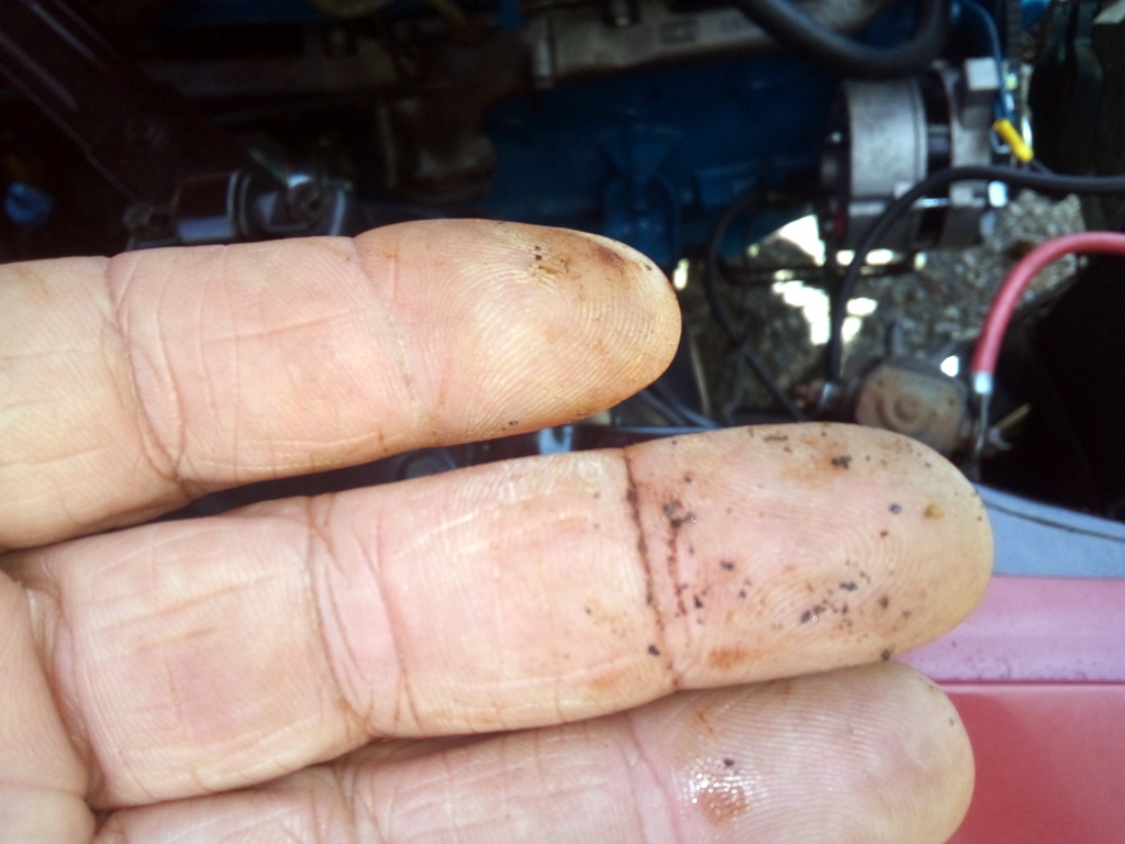

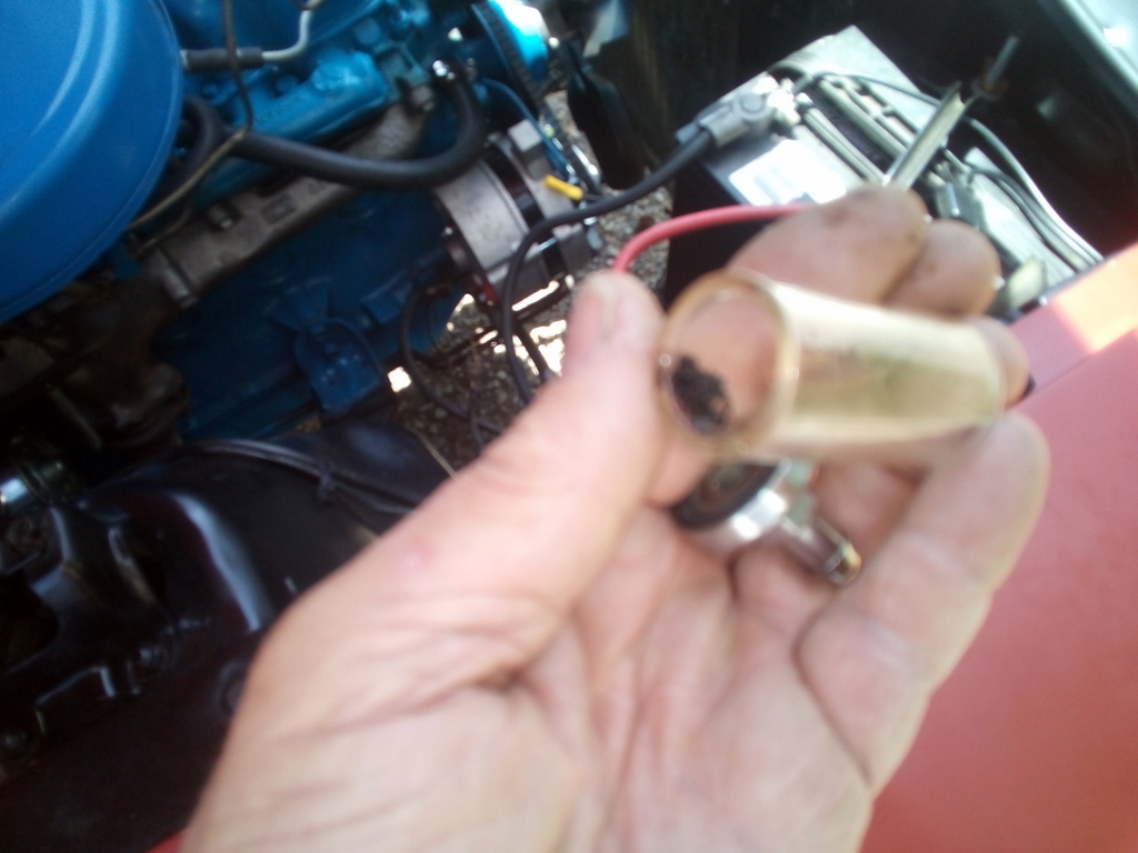

I'm currently experiencing the same problem with a 1966 Mustang that hasn't been on the road for 15 years. I got the car running but the inline filter keeps clogging up with globs of rusted metal causing conk outs while driving.
