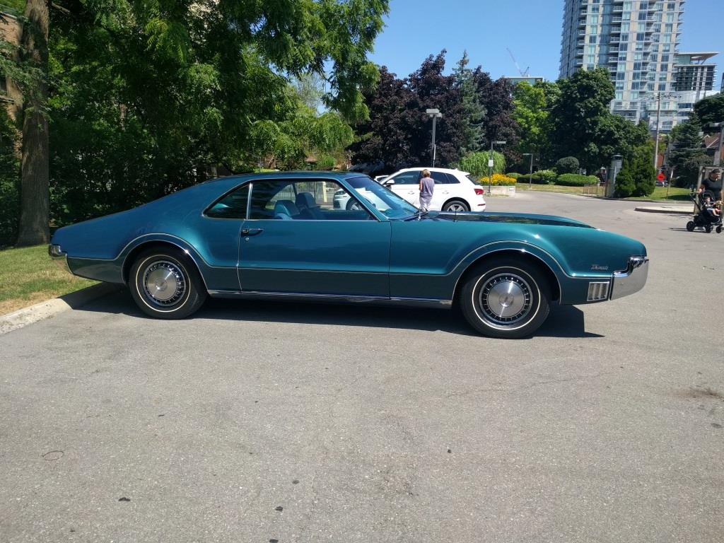

Hello,
It looks like I have to replace or repair a rear window regulator & motor on my 1967 Toronado: It will not open from the fully closed position
I've had the back seats & elbow rest panels out a few times, and have gained access to the bottom of the regulators. Once loosened from their bottom mounts (3 bolts) they work fine; but upon retightening they'll fail after a while. I believe it might be a dead spot on the motor armatures; they don't appear to be seizing.
I hesitate to remove the interior upper quater panels in order to fully remove the regulator. The manual seems to indicate that window moldings and the rear deck have to come off.
I wonder if anyone has had experience with removing a regulator (or just the motor). It would be appreciated.
Best regards, Jody

Greetings, Jody;
Beautiful Toronado!
