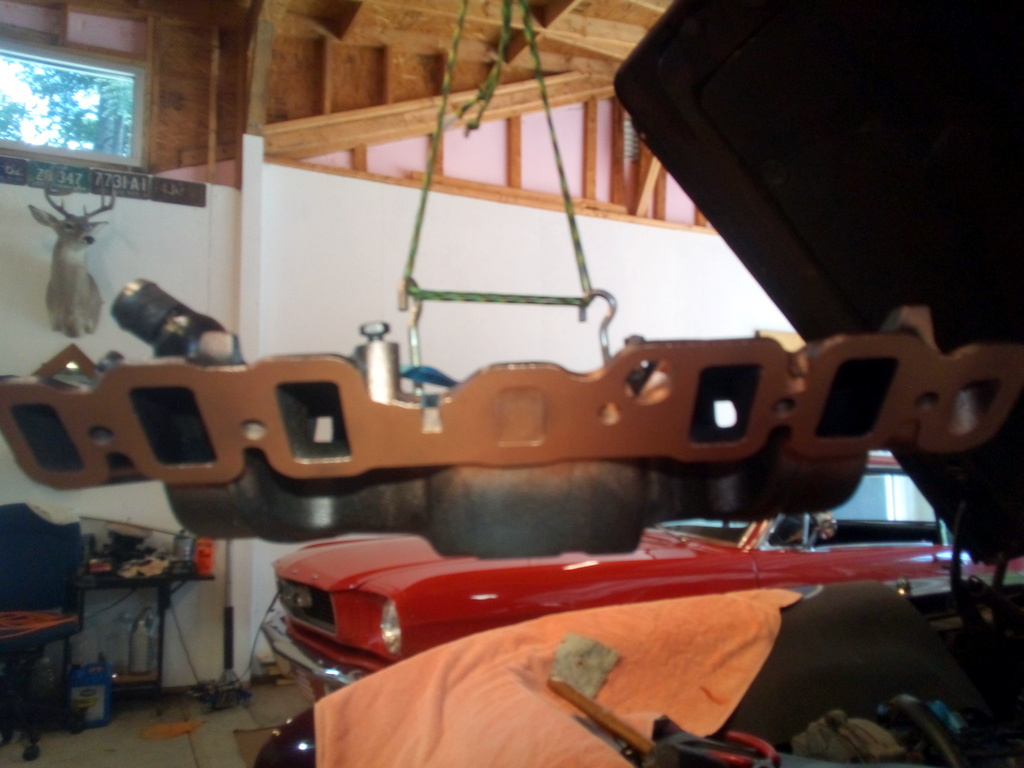

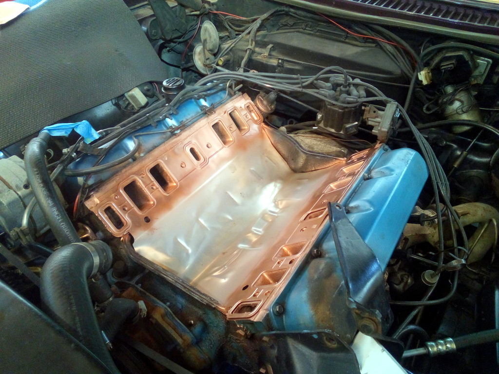

The intake manifold is fairly easy to remove but you'll need to buy a new gasket. Did you use the single piece valley pan with the end seals or did you use two separate gaskets on the heads?
What did you use to seal the intake? I did not use RTV except in the corners of the rubber end seals. I used Permatex Copper Spray gasket on the heads and intake and both sides of the valley pan. It worked perfectly.
Coolant could also be coming through the head gasket(s).
I would do a compression test on all cylinders. It might point you in the right direction.

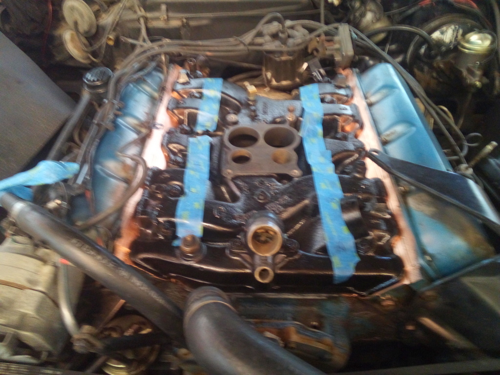

The valley pan is pretty easy to install. I ordered it from Advance Auto.
It has 4 locating tabs to secure it in place on the heads.
Coat the intake and the head mating surfaces with a moderate coat of copper spray and coat both sides of the valley pan mating surfaces with a thin coat.
Torque the intake bolts in the order specified in the shop manual. That's what the painters' tape on mine is for. I had all the bolt holes numbered so I could do them in the order prescribed.
