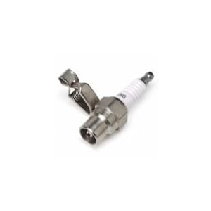

"Dwell" with an electronic ignition is built-in, non-adjustable. "I" would buy a spark-tester. If the spark is verified to be adequate, the module and coil are almost certainly OK. If the spark is not adequate, either the module or the coil could be defective. Personally, I wouldn't walk across the street to get a free Pertronix or Unilite module; but not everyone feels that way. What the hell, you already own the Pertronix.
My preference for NON-HEI spark tester (but there are other styles and brands that can work just fine.)
