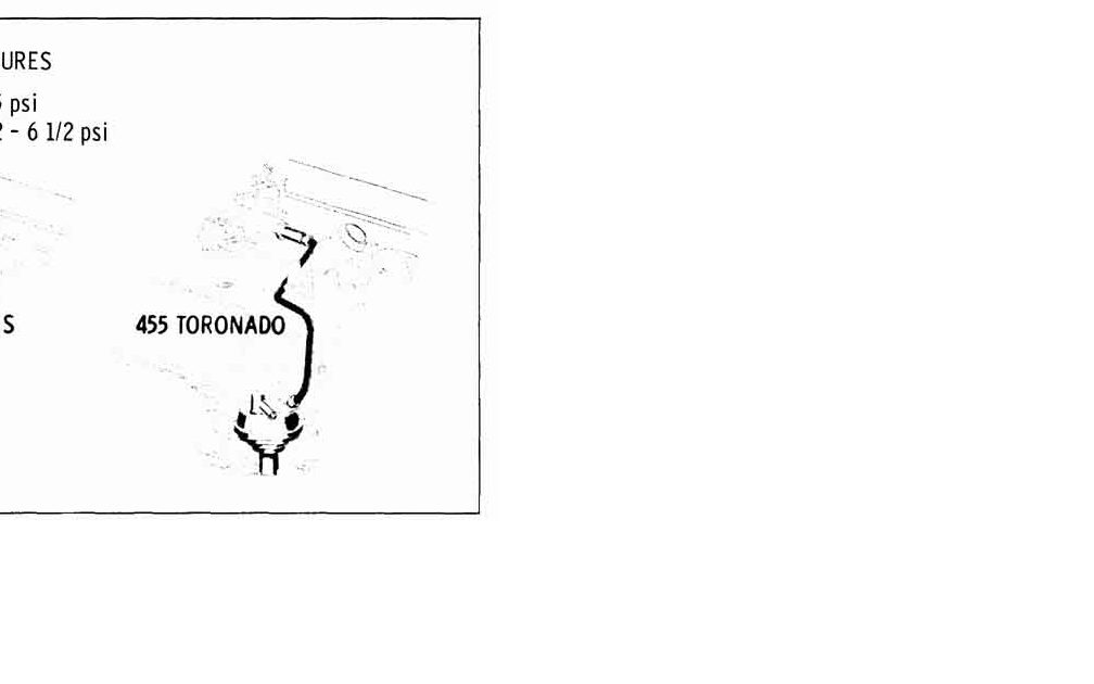

do u guys have any idea where i can get that fuel line?
car is 1970 olds toro GT

You may have to buy a straight piece, and bend it and flare it yourself. Not a hard job, with a little patience.

You are pretty much confined to bending one yourself or finding one in a junk yard. They just aren't available. Inline Tube may be able to help, but you may need to supply the proper length and details. I'm not sure.
