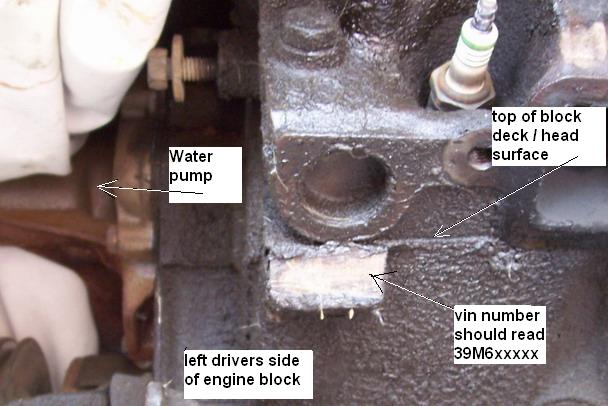

Hard starting and dieseling are result of lower compression, poor state of tune, foul gas
bad valves / rings and and /or any combination of the 5. Not to mention vacuum leaks.
where to start ..... there are a lot unknowns here so lets first get some questions answered:
How long have you own the car?
Previous to your ownership what do you know for sure of its mechanical history,
as in has it been rebuilt or other wise molested?
Does it have it original motor, if so, why does it have a 68-up air cleaner and what appears to be the twist on oil filler cap.
If not, check to see if it has a VIN stamping (see photo) found on 68 and up motors
if so it will read 3xM6/7 xxxxx. The X will be the year as in 8,9,0,-1,2,3 the 6 or 7 will be the decade 6 = 68-69-70 7 = 71-72-73 etc
Compression on the 71 and up motor dropped considerably so lets see where the answers take us.

- Eng Vin stamping 68 up.JPG (44.71 KiB) Viewed 8576 times
