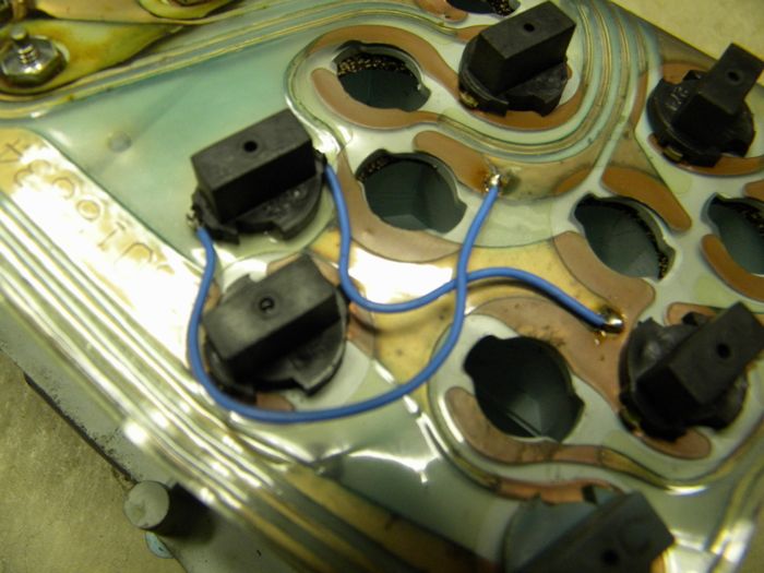

I have patched up a lot of bad PC boards by soldering wires to reconnect
or better connect things. In some cases lower the overall resistance to
improve accuracy. It is also possible to get & use modern connectors
and move them into a cable in place of originals. Might need to add
wire to bypass a bad pin. Some connectors have "lifetime" gold contacts,
such as the "miniature D", up to 25 contacts. Or the waterproof auto
types come in multiple contact positions.
Had bulbs that wouldn't stay on, because the heat over time had distorted
the snap in contact area. I connected wires from the board to the socket
to carry the current, long enough to still access. Don't reverse these, or
the lamp circuit shorts out. Bruce Roe
