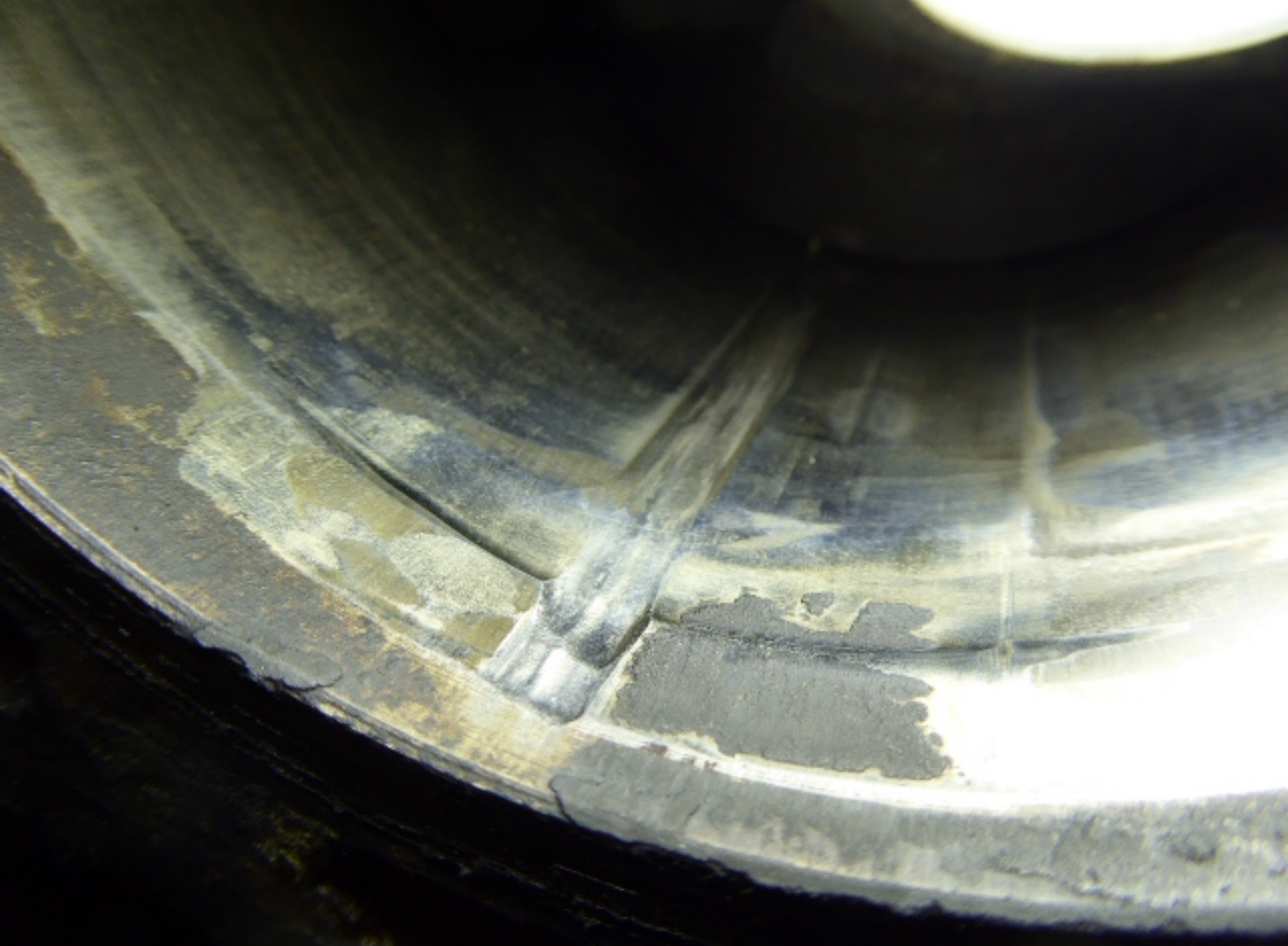

Hi so on my compression test, each cylinder shows 150 except for #7. This one shows 30 dry,32 wet. Also when I hook up air to the cylinder top dead center, I can hear the air rushing through the exhaust manifold. The blowby is strong and visual. How can I have so much blowby if the exhaust valve isn't seating properly???

Amazon has a cheap boroscope. you might wanna look in that cylinder. lord knows my 350 did the same thing and had a hole

Hi thanks for the response. I do have a borescope. There is some ultra light scuffing on the cylinder walls and the top of the piston has some notable catbon buildup. I'm deciding on finding a replacement engine or rebuilding mine. Any advice would be greatly appreciated thank you.

Slick66 wrote:Hi thanks for the response. I do have a borescope. There is some ultra light scuffing on the cylinder walls and the top of the piston has some notable catbon buildup. I'm deciding on finding a replacement engine or rebuilding mine. Any advice would be greatly appreciated thank you.
rebuild is probably the easiest since the toronado uses a ultra low intake compared to a normal 455 plus it's getting hard to find 455s. it's hard enough that I'm having an easier time finding big block bucks and cheap 454s that would bolt in.
it seems like you probably just have some excessive clearance in your piston rings for some reason. how many miles are on that engine?
