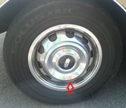

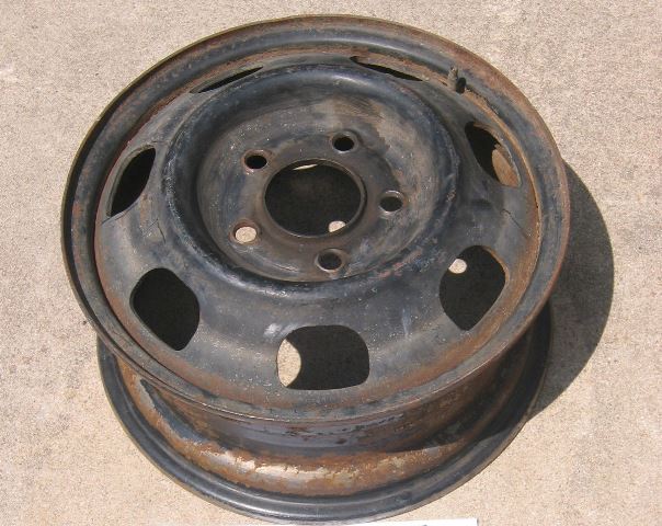

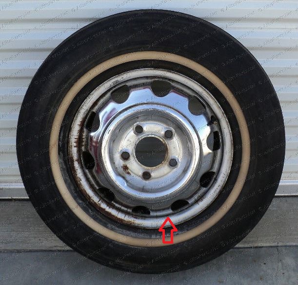

Postby Otto Skorzeny » Mon Oct 12, 2015 5:28 pm
66 trim rings will NOT work on '67 disc brake wheels. The valve stem is in a different place and the width of the two trim rings is different.
Toro wheel, 10 hole.jpg (55.78 KiB) Viewed 19024 times
Toro wheel, 7 hole.jpg (63.61 KiB) Viewed 19024 times
Toro wheel,1967, 10 hole.jpg (141.64 KiB) Viewed 19024 times
