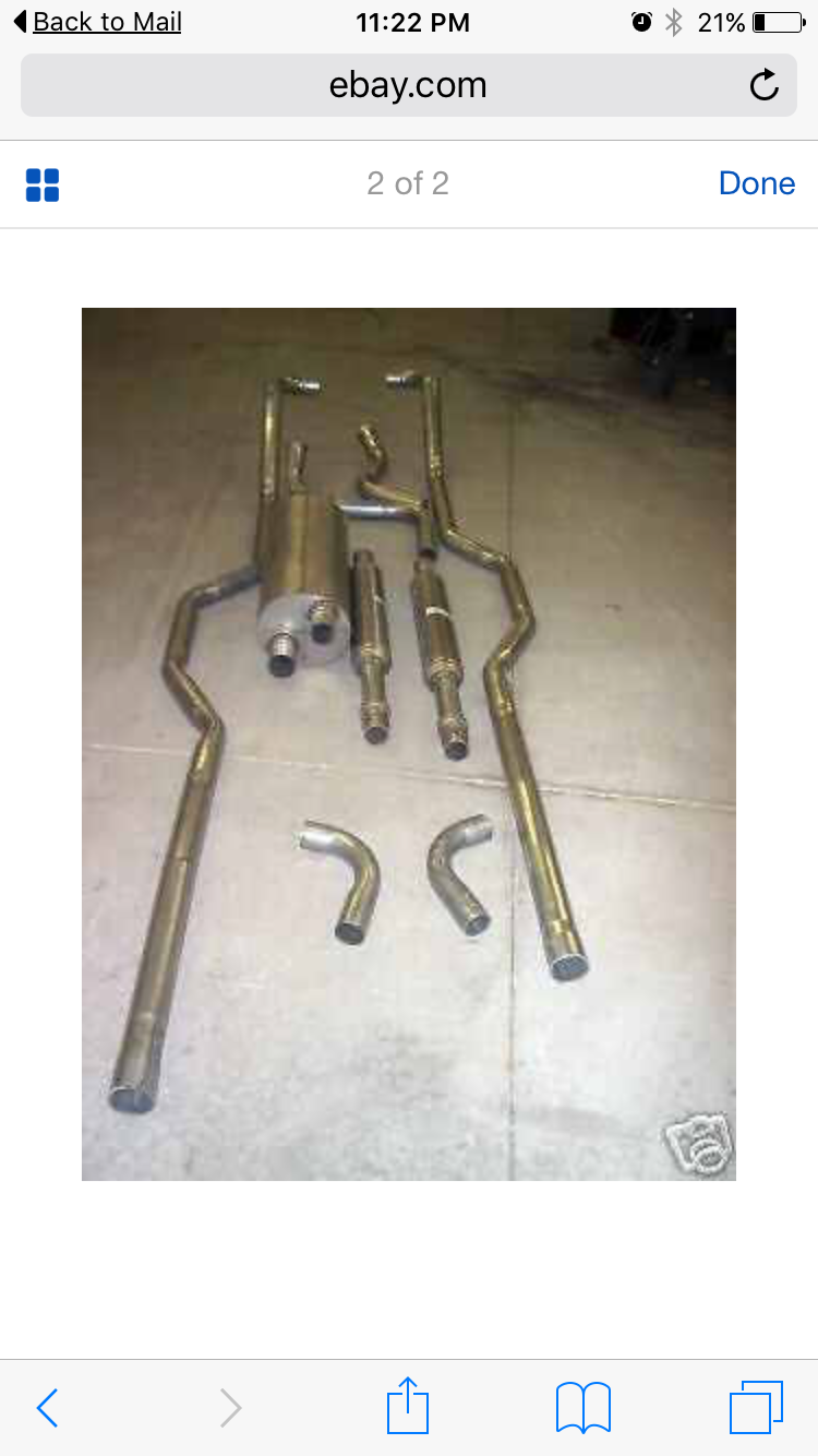

Hi fellas - I need a new exhaust system for my '66 Toro. Looking around on EBay I found what seems like a pretty good deal. Full aluminized system with resonator delete pipes for $347.60. The guy is located in Geneva, Ohio and has pretty good feedback (>4300 with 99.1% positive ). He sells systems for many makes and models. Shipping would only be $65. Looks like he's only 100 miles away so I could even drive out to pick it up. System is complete although I'm not sure if clamps are included - but they're cheap. Stainless is available for $780. On eBay the guy's name is sat1966. Anyone here ever deal with him?
The photo shows resonators - the system I want would not have them.
I see that some folks have bought from Waldrons but they are about $150 more for the same system.
Let me know what you think.

Muffler is wrong. Don't buy this.

Appears to be cheap, crush-bent tubing. Buy local, pay less, no shipping cost, hangars and welded joints included. It'll still be crush-bent, though--inferior to mandrel-bent tubing. It's near-impossible to get a mandrel-bent system at a local muffler shop.

Doc Hubler wrote:Muffler is wrong. Don't buy this.
Doc - what's wrong with the muffler? Will it fit? I'm not so concerned about originality - but I do want it to fit / hang properly without modification and of course it has to sound decent. Thanks!

The muffler, for one, doesn't look like the right fit for the car. THose go in a specific place behend the rear seat kick up. They are oval in design, this looks round.
