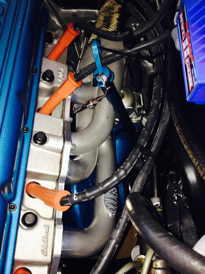

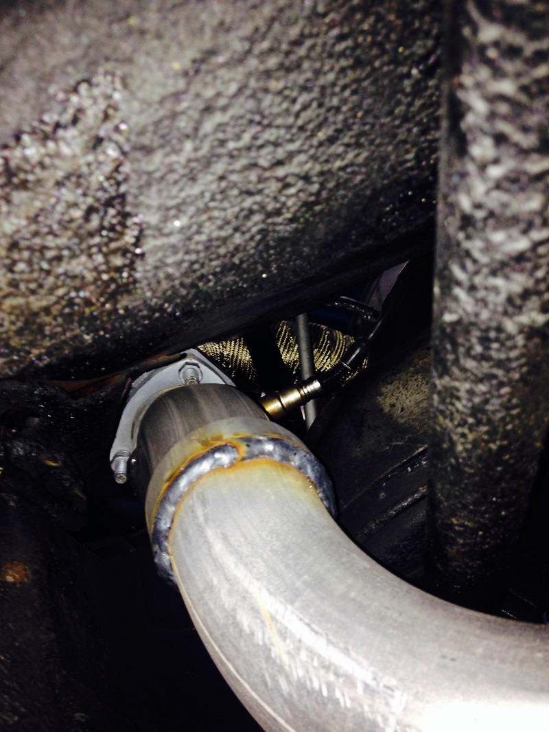

last pics

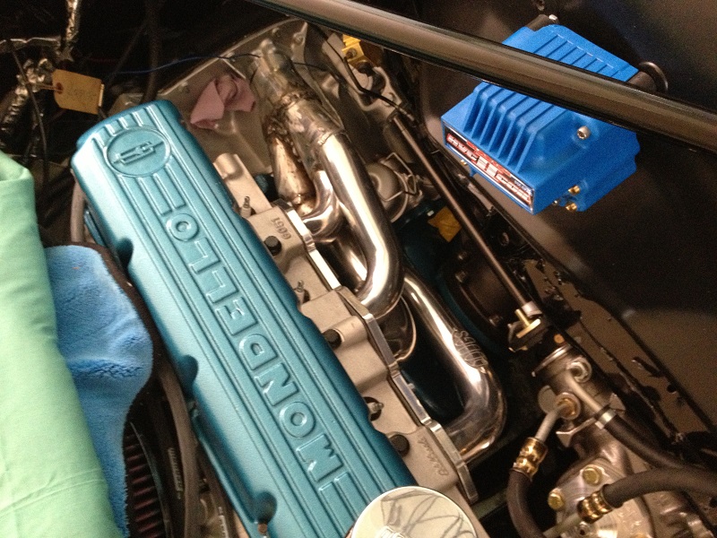

..dont like how he built the drivers side

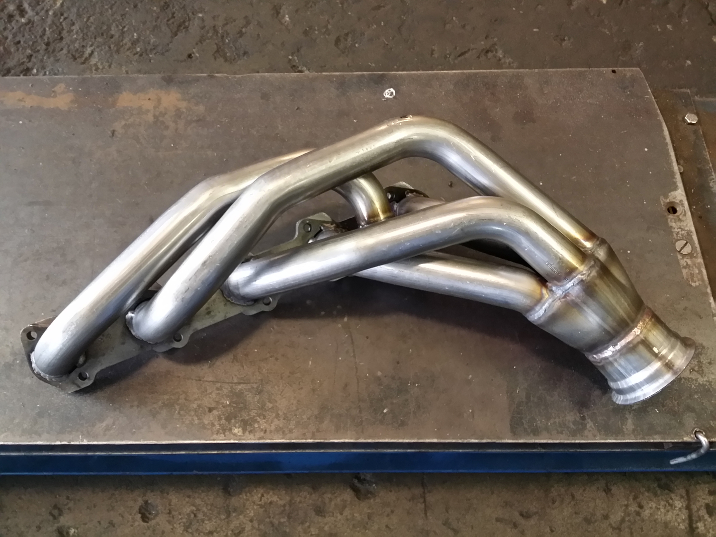

Please tell me more about what needs to be done to install those headers. I have been desperately looking for a set as I know the stock exhaust is about as crummy as it can get...
I gather they came from Applied GMC? How much modification, if any, was required to install?

these pics are from a 1971 toronado. a guy from classicoldsmobile.com sent them to me.
second picture: on the left passenger side header, right is driver side header. right after welding, before coating.
third picture: headers before modfication. on top passenger side header, below drivers side header.
these headers are the same headers you can purchase via appliedgmc.com or doug thourley for GMC motorhomes. he didnt not told me much about the process but from the pics you can tell he pretty much cut the header passenger side right on the flange and took some material off to make it fit. he also told me that he needs to cut some material out of the inner wheel well on that side. you may run into clearance issues with the A/C hoses comming from the compressor. but that could be solved by installing the 1971 toro type hoses since they came with an angled-type flange.
as for the drivers side...that thing he built cant be right. these headers are meant to be tri-y headers...but he built some sort of..i dont know..frankstein header on the drivers side. the runners are way too short IMO. on the drivers side you need to cut them somewhere after the first Y-collectors and route around the steering shaft..thats the point where it gets tricky, since the 1971 toronado is a bit different when it comes down to exhaust routing in that particular area compared to 1st gen toros.
maybe you could use defroster duct on the engine first to get an impression how you would like to route the pipes.
i already have a set of those headers but need some time and money to get it all done

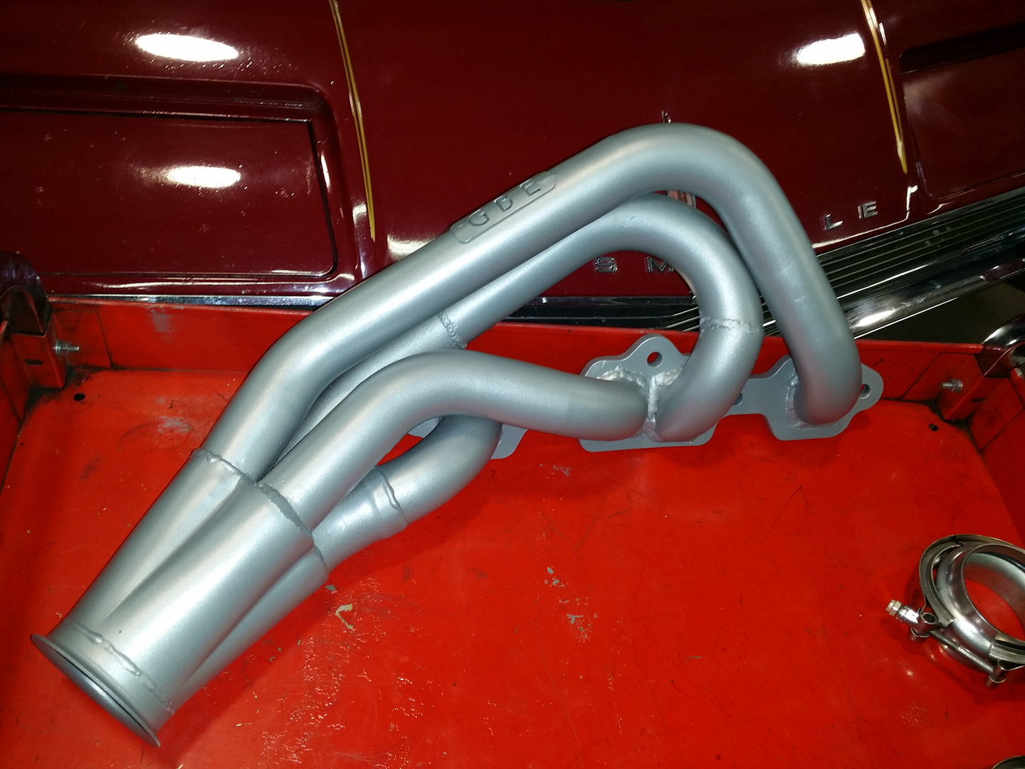

found something interesting. seems like those guys did a set of headers for a 1966 toronado:
https://www.gbemandrel.com/marman-flanges.html
shorty style headers...would that make a big difference compared to stock manifolds?

Eightballz wrote:hey there,
The upper photo cannot be for an Olds engine. The exhaust flange is all wrong. The pipes are evenly-spaced, but Olds has the middle pipes siamesed.
- Eightballz
- TOA Membership Number: 826
Re: th425 550hp /600 tq
haha you are right...and i also count 5 exhaust ports
