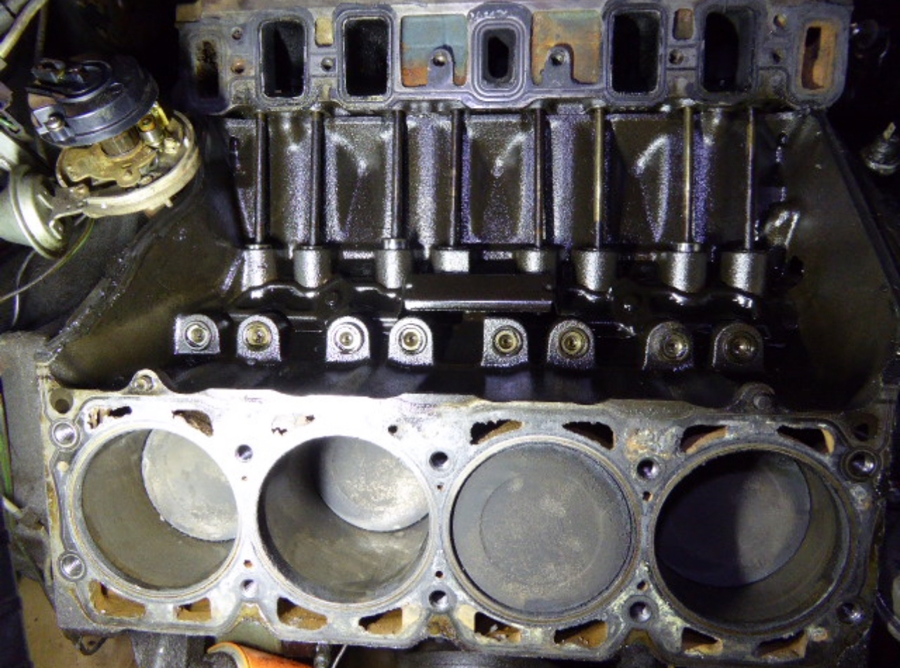

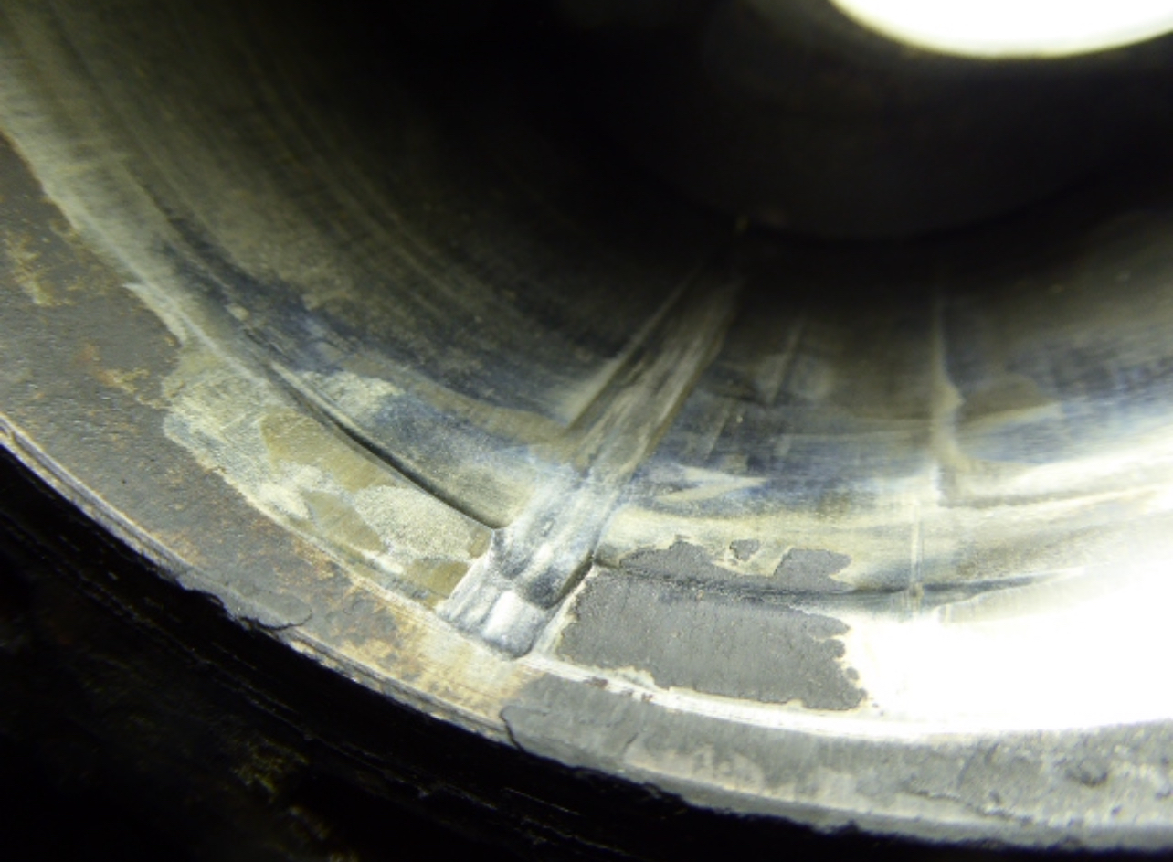

Is that the piston head? If it came out that clean then you had a head gasket leak. Is the piston scored? It looks that way in the picture.

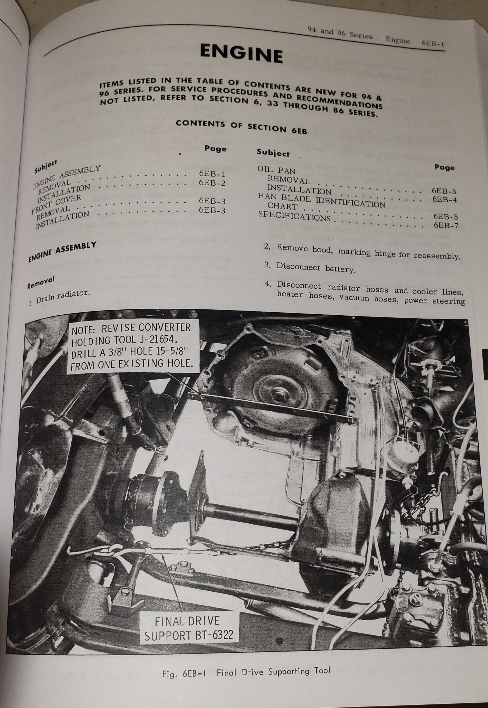

Hello all, Toro guys
I need your help. Would you like to tell me if I can put down the engine without to touch the transmission? Where is the suspension of transmission?
after put down The engine is transmission and differential fully stable or I need a special equipment to protect it?
To take off the engine I need at the front two screws on the right side two screws and on the left side … the rest are only a screw on transmission
is That right or the fix points …on another position
With best regards
Wojtek

Postby Slick66 » Sun Sep 22, 2024 9:06 pm
Hi Jelonek, you can take out only the engine but you must securely support the transmission. You do not want the transmission to move down at all. I belive there is some unbolting to do near the axles/differentials. Also take special note of the front engine mount.
