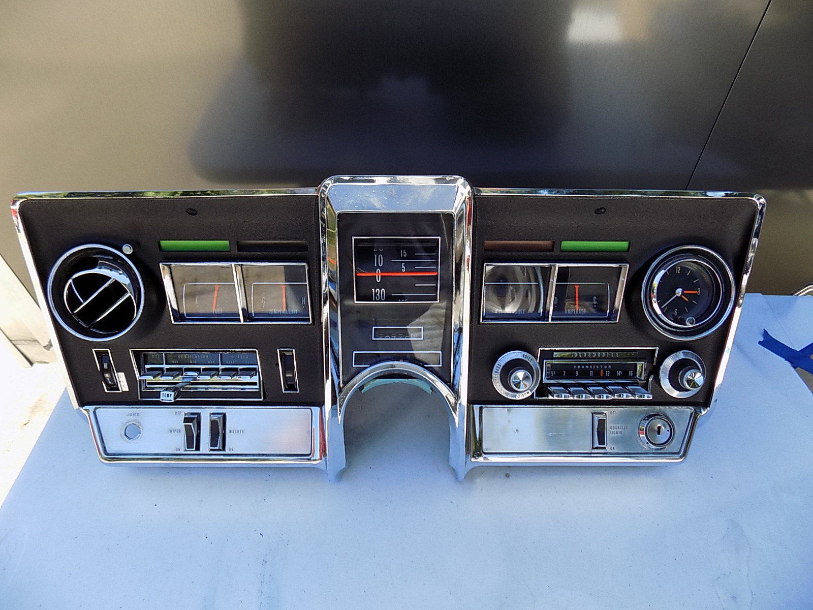

Re: Remove Dash Cluster
I restored the cluster on my '66 this past spring. Removal is pretty straightforward. Lower the steering column- two nuts on studs. Be careful not to overtighten on the reassembly- one of mine snapped on me and I had to drill it out and replace. I think they might be shear bolts, because it snapped without much pressure at all.
If I can be of any assistance, please let me know. I took a fair amount of photos. Before and after below.
- DSCN0312.JPG (476.2 KiB) Viewed 29617 times
- DSCN0301.JPG (508.36 KiB) Viewed 29617 times
What did you use for the green lenses over the turn signal indicator lamps?
I think it's pretty straightforward, but heavy and awkward. An extra set of hands would be useful in my view. Also, that is a good time to replace ducting for the vents which usually goes bad. Check out all wiring connections as others have mentioned earlier. I used some green plastic file folder materials for the turn signal lenses which have no markings on them (arrows). THankfully, the other lights with lettering (Brake -red and Hi Beam - violet) were in good shape, so they were re-used. I would include a picture of mine, but this site is a hassle regarding picture sizes. I used crinkle paint from Eastwood to redo the dash paint. My car has been a complete restoration project. Getting close to upholstery only to finish it up. A few mechanicals to yet be gone through.
Wow great job c man
I need to do the same thing but I'm scared of the vacuum lines do you any advice for me
And the bezel where the power antenna and light switches are is pretty rough I don't if it could be replaced
