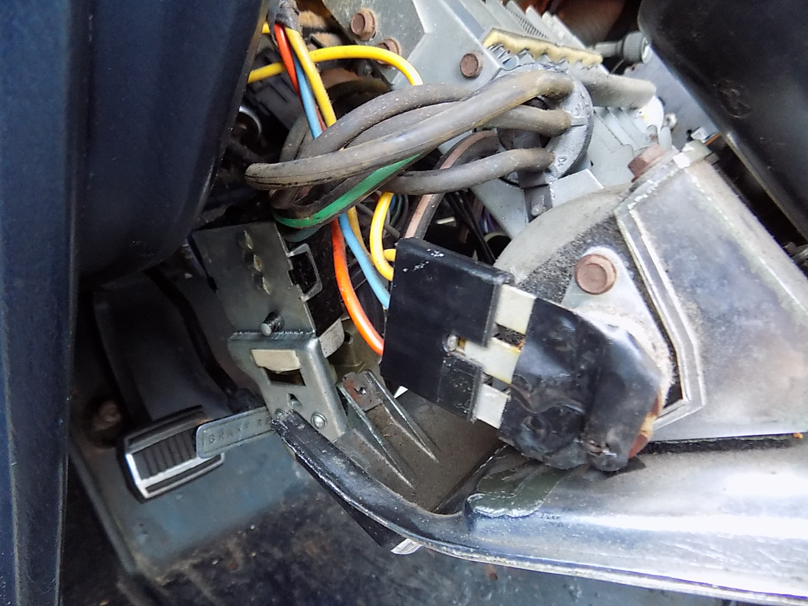

Don't be afraid of the vacuum lines. As I recall they are color-coded with a colored stripe on the vacuum line and a corresponding color on the port. They are numbered too. Mine is not Comfortron. Take photos and notes so you can remember how it goes back together.

I have my dash down right now. take many pictures and label all vac lines
