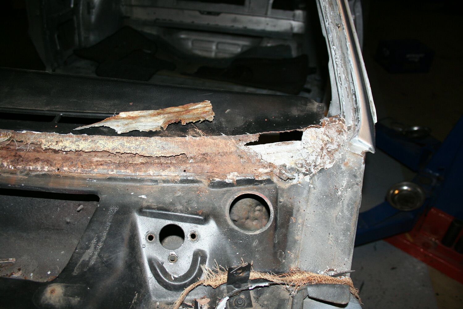

Hi guys ,
first of all . . . my topics/account ?. . . were deleted due inactivity thru the last year.
I was registered in 2015 when I bought my 66 toronado.
what do you use as windshield channel ?
mine isnt existing . . . just a kind of bondo/silicon stuff.
does anyone has a reference or source of rubber that you use ?
Or maybe anyone can give me the measurement or cross section of the channel ?
thanks guys . . .

Re: windshield channel 1966 Toronado
Postby Otto Skorzeny » Tue May 01, 2018 1:54 pm
Check out the link I put in your other post. Harald Schoener, in Germany , had the same problem as you. He has pictures which might help you and would likely be happy to help you if he can. He's restoring a 1956 Cadillac right now. He finished his '66 Toronado and it's beautiful

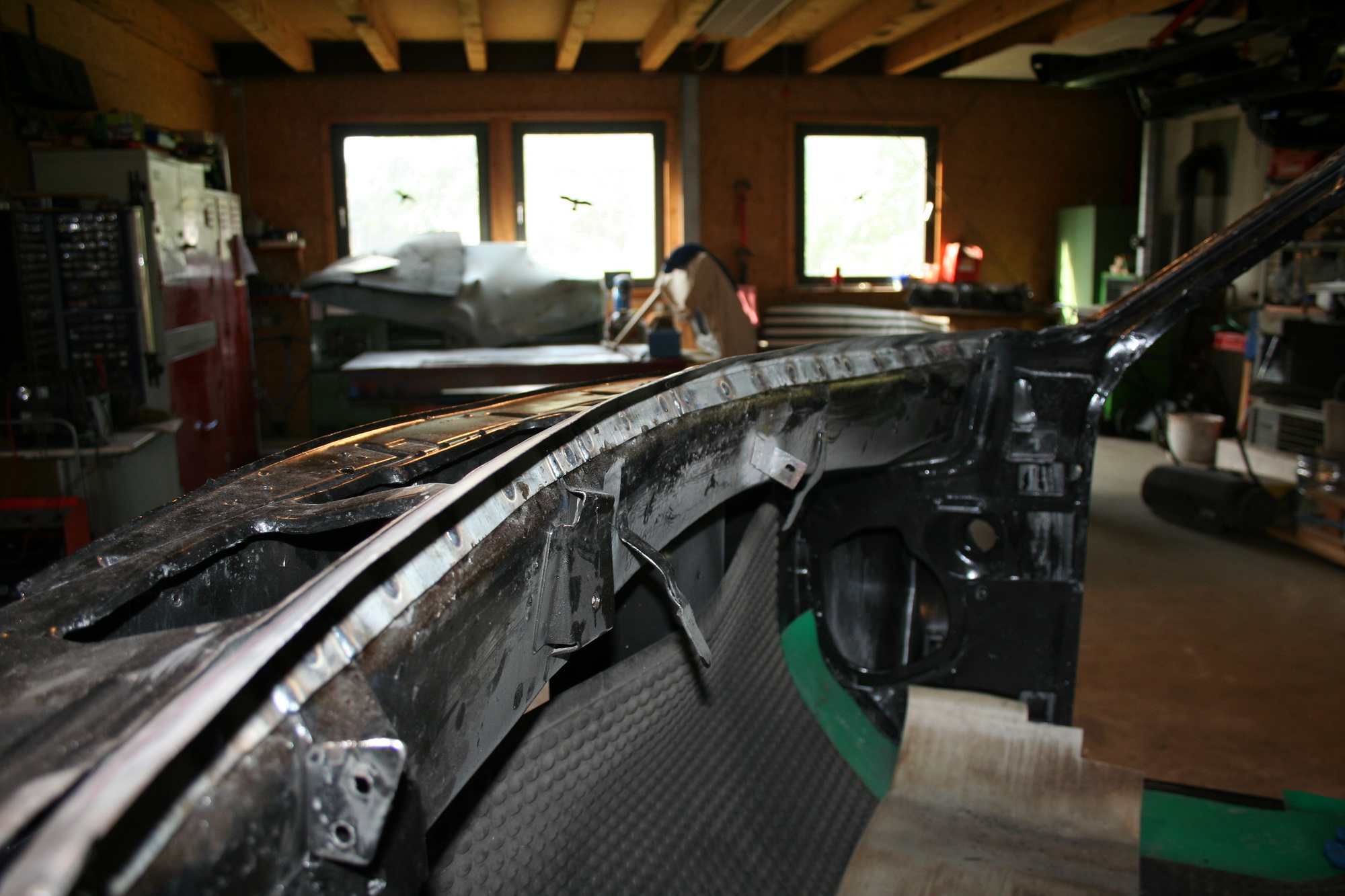

Postby harascho » Thu May 10, 2018 9:31 am
Ok Gents...here I am... please excuse me the 1956 Caddy eats up all my time..;-)
harascho
Posts: 106
Postby harascho » Thu May 10, 2018 9:39 am
and the solution:
harascho
Posts: 106
Postby harascho » Thu May 10, 2018 9:40 am
and more..

Postby MNfirefighter » Mon Jun 11, 2018 7:56 pm
Great job on the repair, I have this to look forward to on my 66. Maybe not to that same extent but I seem rust holes in my corners.
