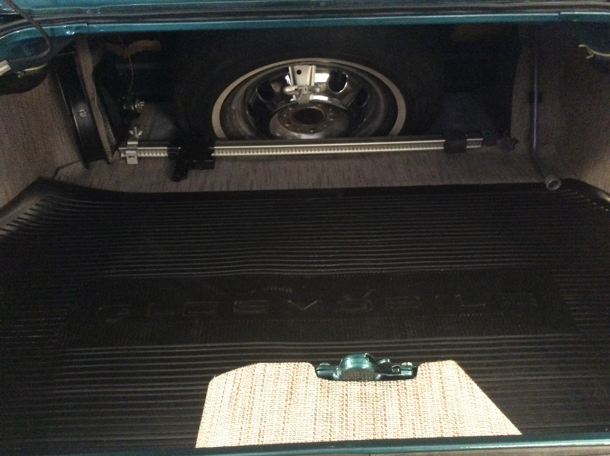

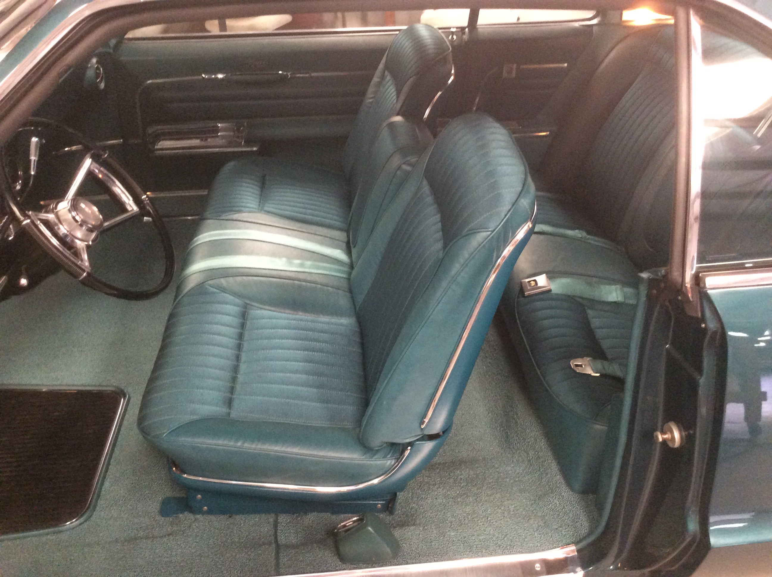

66 Floormat
Tuco
Re: 66 Floormat
Ridges not Robles. Damn autocorrect.
- B4895A2A-B596-492D-97CB-5DCBC0340075.jpeg (1.41 MiB) Viewed 17461 times
- FCDC694E-F123-4F5F-B855-52EEA0BC8EB8.jpeg (1.04 MiB) Viewed 17461 times
- F6BD35C6-F386-443C-8152-9D376FEFFB10.jpeg (999.75 KiB) Viewed 17461 times

Re: 66 Floormat
Wow! That floormat looks great. How did you make such clean cuts?
Mine is original and not torn but it has shrunken away from the edges of the metal frame by about 1/2" all around.
I think I'll make a new one like yours.
Where in Texas are you? I just gort back from San Antonio two days ago.
Tuco
Re: 66 Floormat
Hey Otto. I wish I had known you were so close. We could have gotten together. I am just north of SA about one hour. I have vintage cadillacs too.
I made a cardboard template for my floormat. Mine was shrunken away the same as yours. I cut the rubber material a little larger than the template and worked it in from there. Then glued it down with vinyl top adhesive. Worked great.
