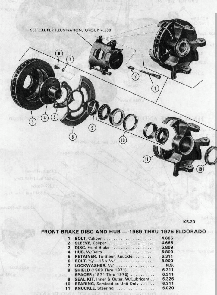

Re: l Bearings
Dewar Trophy be damned, these bearings take gunsmith custom fitting to get right.
In theory it'd seem that the press fit holds the cups in the knuckle. In practice Seal #9 actually acts as a spacer/retainer so that Retainer #5 holds the bearing cups bottomed in knuckle #11. Thus, all these parts must stack up to the correct height.
There is a Spacer (#8?) which went MIA on Cadillac and is not accurately illustrated nor addressed in parts and service literature. It is a 3-hole triangle shaped flat.
I believe, but I'm not positive, that this Spacer was originally of selective-fit thickness.
Anyway, ultimately what needs to be made sure of is that Retainer #5 holds pressure on "bottomed" bearing cups, via Seal #8. If Seal #8 is short, it may seal, but will not help to keep the bearing cups home.
Some Misfit types will drill and tap the knuckle at the bearing spacer (center part of #10) location and install a grease fitting. If the bearing is apart a small notch can be ground into the bearing spacer, that creates a sure grease path for lubricating the bearings.
- Toronado Wheel Bearing Diagram.png (907.03 KiB) Viewed 18793 times
