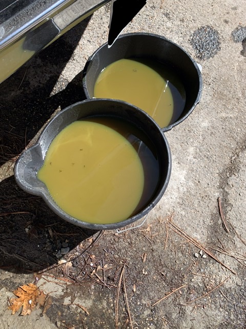

Update: So I did a radiator flush yesterday on the Toro and the coolant was pretty bad. I used two bottles of Prestone Flush Plus Cleaner to remove some of the crud that is in the system. I know it’s not going to completely resolve the issue since the radiator is pretty rusted inside, but should improve the cooling temperatures. I haven’t driven it in the day or in traffic yet, but after driving it for 100 miles last night I did notice an improvement in that area. Before the flush, the gauge would read about 210 degrees Fahrenheit when driving at night at around 65-70 mph, and now it reads 200 when I go 70-80 mph. At 65 it would stay around 190-200. Now to truly test it I would need to drive in traffic during the day.
Did I have to turn on the heater when I did the flush? The heater and blower motors don’t work so I didn’t have much of a choice.
