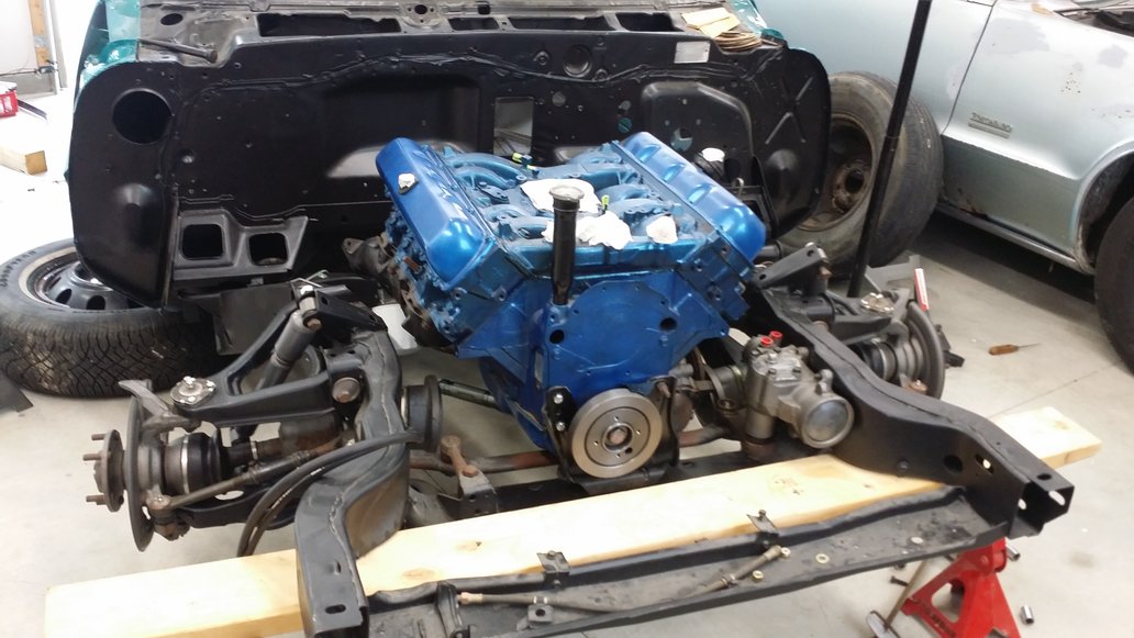

Postby 1970w34 » Mon Jul 24, 2017 7:35 am
I work best alone it seems!

Never gonna understand the picture attachment stuff...trying to show the final mount pic taken the same day on the same camera as the others "file too large" :roll:
1970w34
Posts: 208
TOA Membership Number: 38
Years Owned: 1970 multiple
Re: Makin' it happen
Postby 1970w34 » Mon Jul 24, 2017 8:07 am
Maybe?

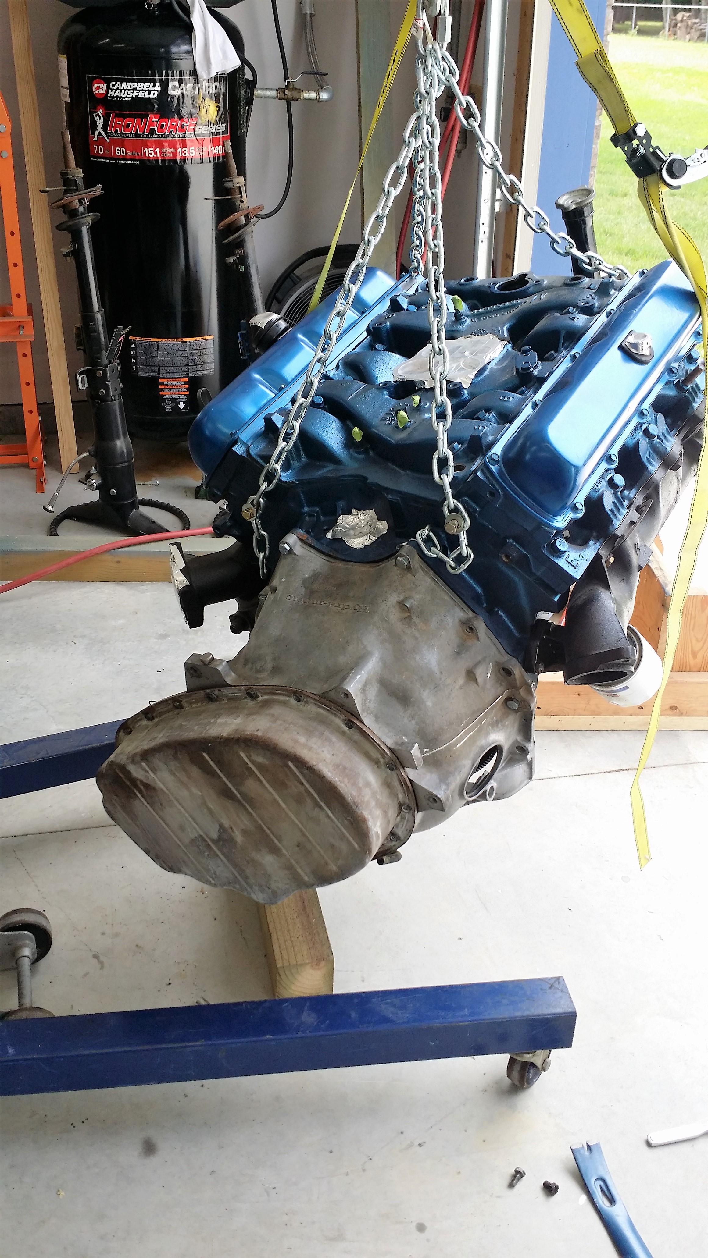

Forgot to put the rubber cover on the chain case so when I reboot next week I'll see if I can sneak it on without having to take the whole thing out again :oops:

1970w34 wrote:Here's a tip!
When mating the TH425 and the block back together, MAKE SURE that the torque convertor is ALL THE WAY IN. It seemed to be in, but it wasn't!
I was getting interference on the trans case and then saw the small relief cut that GM put on the case. Another 3/8 inch or so deeper went the convertor and now all is well! :D
Its hard to know what damage might occur if the converter isn't all the way
seated while you are bolting the engine to the trans, nearly an inch back from
the bell housing. You must have a freely turning converter with the engine
bolted; then you pull the converter forward a bit to get it up to the flex plate.
Bruce Roe

Postby 1970w34 » Mon Jul 24, 2017 5:08 pm
Bruce Roe
It slipped back when I was manipulating the package but I used a slightly longer bolt to pull it in as I went around, seems to be good. We'll see! :)
