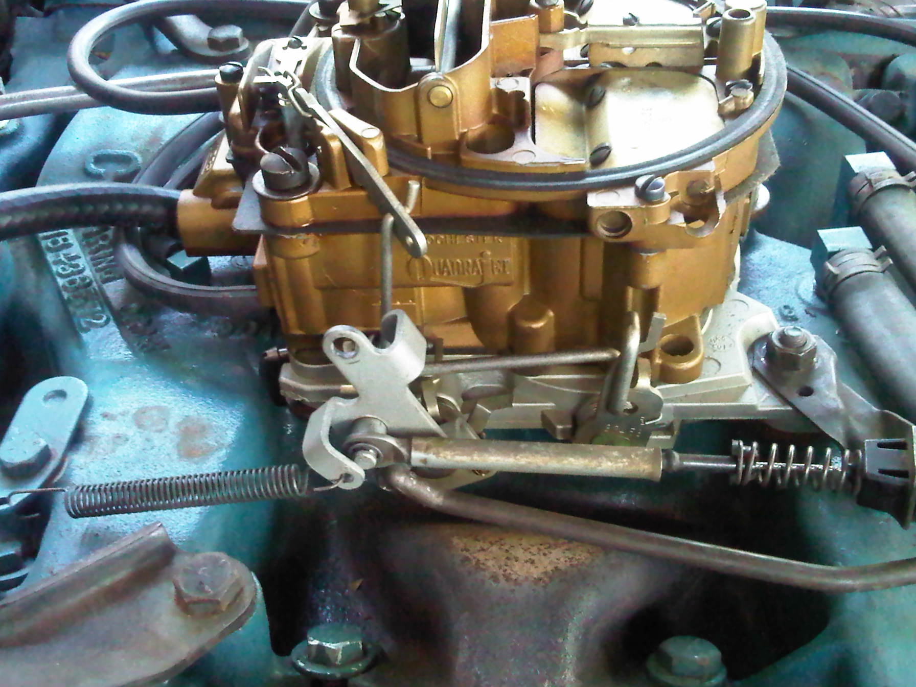

Re: wide open throttle problem
Hope this photo helps from my car.
- Carb3.JPG (995.25 KiB) Viewed 13202 times
Thanks, can you post a pic showing the rest of the rod and the adjusting threads?
