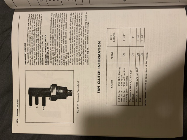

Actually, I just noticed something. There are no lines going to the thermostat vacuum switch. Could this be another reason why the car is overheating?

My car doesn't have one but from what I read on the picture you posted it looks like it might have some effect at idle - when stuck in traffic.
Hopefully it shows the vacuum line routing.

The good thing is that the chassis service manual shows a diagram of the routing for the hoses. I’ll see if I can fix that.

That thermostat vacuum switch is one part of the emission system of the late 60th. It lowered the exhaust emissions in different ignition timing with cold or hot engine. Without that working thing your engine produce the same oxide as a 66 engine.

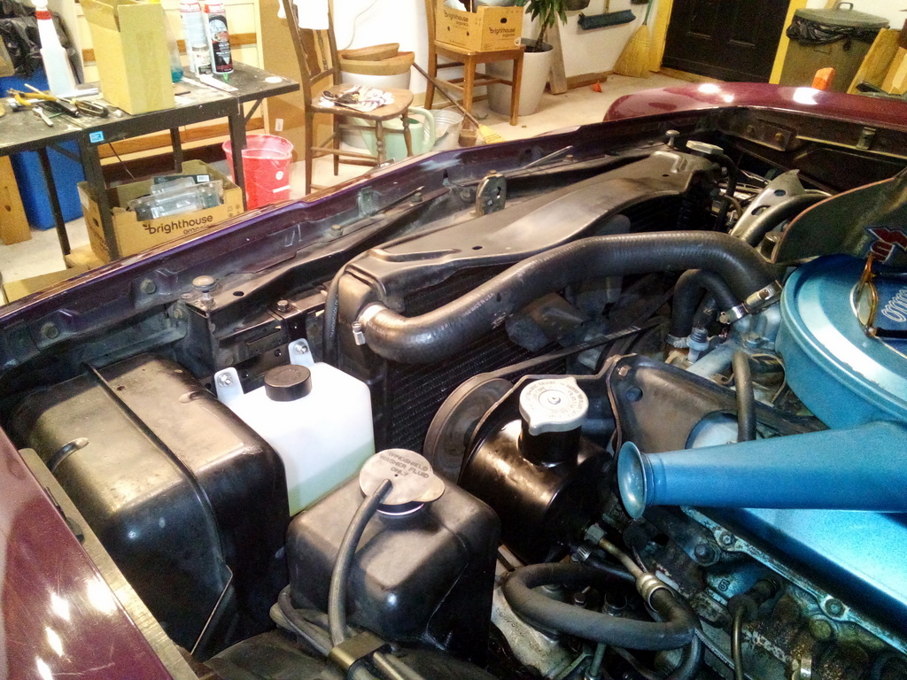

I know you're in California. Are you required to pass an emission test? If not, I'd remove the air pump and all that crap.
Fill the radiator up to about 1 1/2" below the bottom of the filler neck.

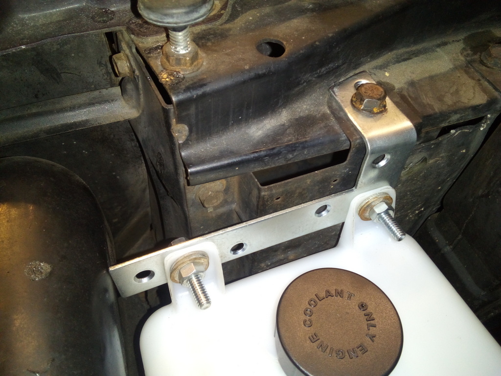

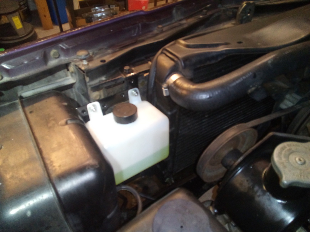

I installed a coolant reservoir on my car. It looks stock and works perfectly. With the coolant reservoir, you can fill the radiator to the brim. Be sure to use a modern vented radiator cap so that the coolant can flow both ways.
If anybody wants to install a coolant reservoir on his car to keep it from pissing all over the road, this one from Dorman is pretty nice. It has the nipple on the bottom to act as a reservoir instead of just a recovery tank.

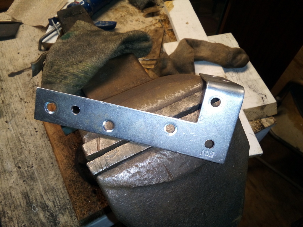

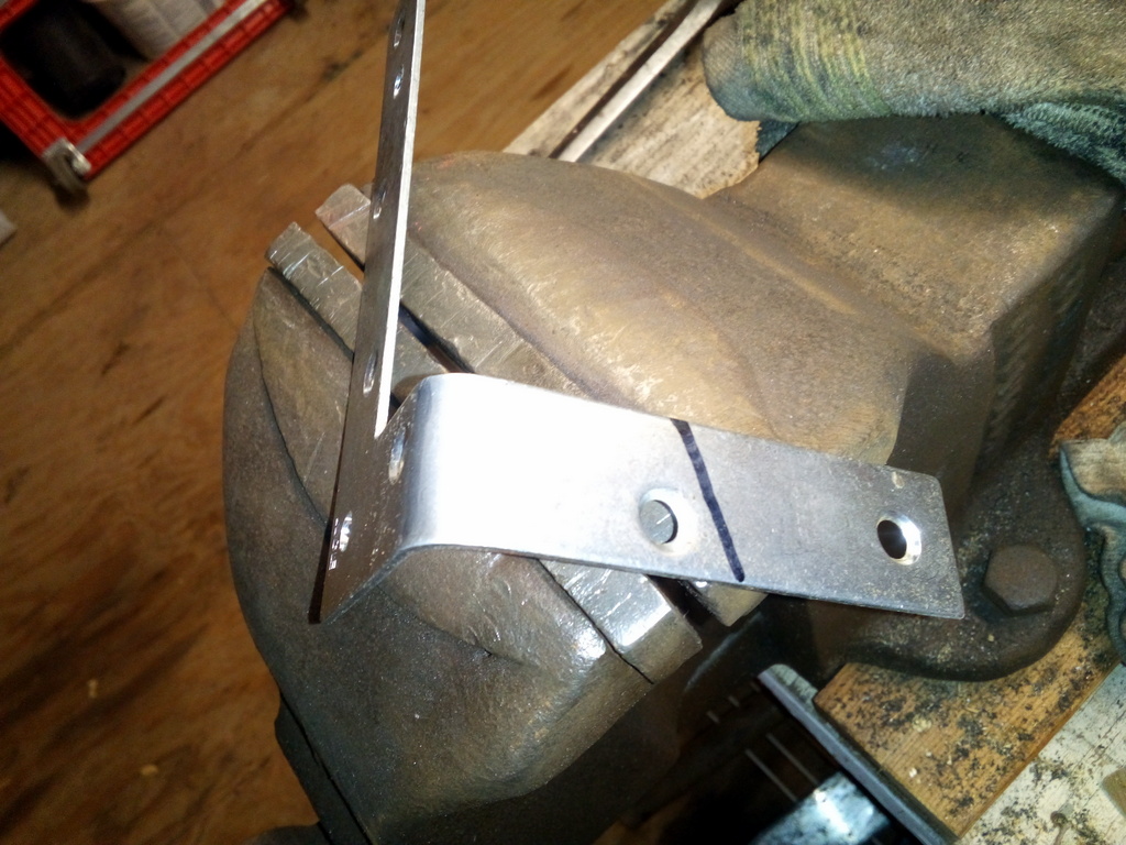

Anyway, it fit the available space perfectly. I made a bracket from a flat L corner bracket. I utilized an existing bolt on the radiator support so no drilling on the car required.
Dorman part # 603-001 6.5"w x 5"h

In California, cars that are built from 1975+ must perform a smog check, so in this case I’m fine. The car doesn’t have an air pump, so that’s not much of a problem. Someone installed a reservoir tank before I bought the car, but I replaced the cap with a non-vented one. I didn’t know that you were supposed to use a vented cap for the system to work. No wonder the coolant kept disappearing haha
Re: Fan Clutch
NicolasB wrote:In California, cars that are built from 1975+ must perform a smog check, so in this case I’m fine. The car doesn’t have an air pump, so that’s not much of a problem. Someone installed a reservoir tank before I bought the car, but I replaced the cap with a non-vented one. I didn’t know that you were supposed to use a vented cap for the system to work. No wonder the coolant kept disappearing haha
Define "vented".
Caps for vehicles that don't have recovery tanks allow coolant to push out to relieve excess pressure. They allow air to re-enter to relieve vacuum. They're vented.
Caps for vehicles that DO have a recovery tank allow coolant to push out to releive excess pressure. They are sealed to atmosphere, so that vacuum in the cooling system will pull coolant from the recovery tank. They're also vented--but with an addition of a rubber gasket where the cap touches the top of the filler neck.
Thousands of years ago, back in the mid-1970s, aftermarket recovery tanks came with a cheap rubber gasket you'd install on your existing radiator cap to make it work with the recovery jug. In practical terms, that gasket was the ONLY difference between a rad cap for an open system that dumped excess coolant on the ground vs. a rad cap for a sealed system using a recovery bottle
