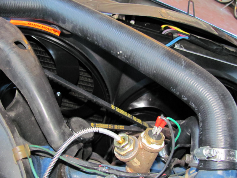

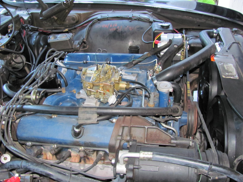

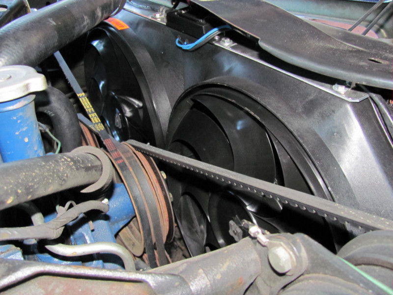

The cost for my Toronado's dual electric fan installation was more than double your estimate. Aggravating factors included fabricating the custom mounting bracket for a solid professional installation and look, work to the radiator core itself including its removal and reinstallation, living in Miami (everything is more expensive here), and a few odds and ends that added to the cost here and there. And the only heavy lifting that I am capable of doing is raising my pen up to my checkbook.
The "computer" is merely the controller.
One item I wish this installation had was a pair of indicator LEDs to mount on the instrument panel, glowing green to confirm fan rotation. I mentioned this to my mechanic who replied that my engine temperature gauge would have to suffice. Temperature rise significantly above that which is normally seen may indicate one or both fans inoperative. Pull over, open hood, look.
Of course he would have liked this setup to have had the LED indicator option also. He bills by the hour.
