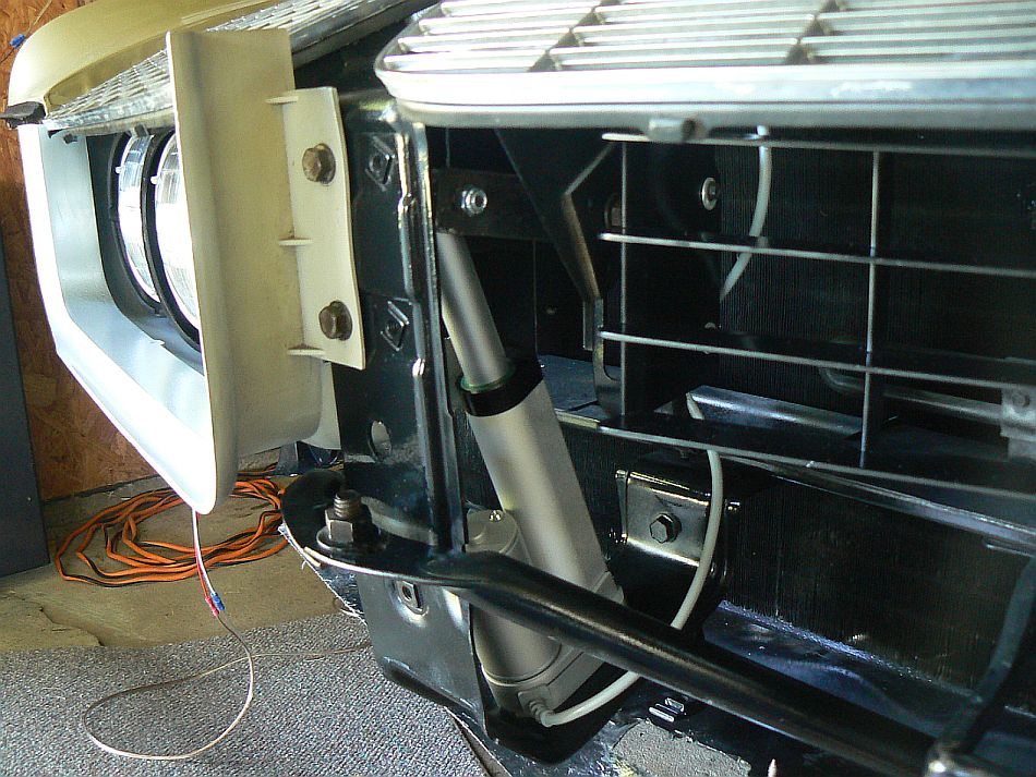

I have discovered a great solution for a failed headlamp door vacuum system on the 68-69 Toronado. The product listed below is almost a direct fit replacement for the stock vacuum actuator. I left all of the other original vacuum components in place during the restoration process. I have attached a picture of the installed unit. The only modification necessary is to slightly enlarge the mounting hole on the lower bracket so the actuator mounting shaft will pass through. You will also have to mount a DPDT switch under the instrument panel that can be reached easily to reverse 12VDC to power the actuator. I am not familiar with the dual 66-67 configuration, but AEI probably has a unit with the correct stroke that would fit in that application also.
Product ID: 302.120_6103T
Description: 3" Linear Actuator with Preset Limit Switch "IP65 Rated"
Price: $105.00
Web Site: http://www.aeicomp.com/ [attachment=0]A6103T.jpg

Thanks. My vacuum actuator had failed years ago when my mom still drove the car. I never considered fixing it during the restoration and finally found this supplier. They provided enough specs on their site that I was pretty sure it would work. I promise that you will be pleased with the result. I already had the front end pieces off to send the car out for painting, but you will have to remove them to get to that lower bracket to enlarge the hole about 1/4". I used a drill press and slowly worked a bit through it.

As for whether or not you can do this for the 66-67 the answer is yes, but you need to match the stroke of the actuator to the stroke of your vacuum unit and you may need two actuators (I do not recall how they worked; they might be connected to a common bar mechanism or they may be operated independently which is what my memory is suggesting).
The key parameters are the stroke length and the overall length of the actuator.

The two lights are on two actuators. If I measure the stroke, and its 2.78 inches, would a 3 inch stroke actuator then work?
Don’t know about the other vehicles, but the 67 has little vacuum switches that hold the lights up. Then when vacuum is applied to them, the lights will drop down. Not sure if that is the preferred method, or would you keep current to the electrical actuators to keep the doors open? Could probably get little electrical switches to do the same thing.
Would rather go fully electrical, or fully vacuum. Not a hybrid system. The vacuum parts are all very old and getting harder to get by the day. This is not a show car, and most people wont know the vacuum system is out if you don’t tell them

I would suggest that most of these actuators are designed to run from limit to limit. You might have to adjust the mounting to allow for a full extend. You are asking some of the questions I was going to be analyzing when I did this.
Assuming that the actuator operates from limit to limit then you will not need to keep energizing the unit. Typically you energize it in a given direction until it hits the limit then an internal locking mechanism usually locks the actuator - although all of this is customizable and so the real answer depends on how the unit he found actually works.
I may get one in the near future to evaluate. If hbarbee does not post any answers before then I will be glad to provide them once I have them.
I do not see any reason for a hybrid system. I would wire the actuator(s) to a DPDT relay, and then provide the input signal from the headlight circuit. When you energize the headlights the relay will close one of the two DPDT throws and the signal will be sent to the extend input of the actuator. When you turn off the headlights this will switch the relay to the other pole and send the retract input a signal. Or so I suspect.
