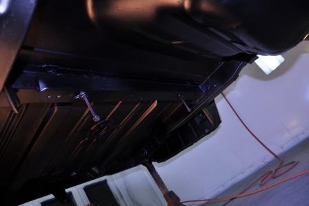

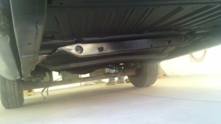

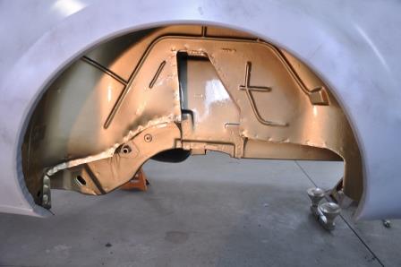

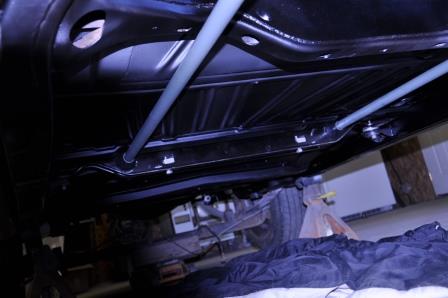

Here are some pictures from the latest. We completed painting the frame, and have joined the body and frame. Tomorrow we hope to reinstall the front suspension. We have painted the torsion bars, and cast iron/steel parts. Later we will remove the rear suspension so we can complete the work on cleaning and repainting those components, then reinstall the brakes.

It took a lot of effort to get the old thick undercoating off the body and frame. Once that messy job was done we were able to seat everything with epoxy primer then paint with single stage epoxy black. The wheel wells were painted body color, and we did them as they would have been done at the Fisher Body plant in Euclid, OH. You can see additional info and monitor progress by going to https://www.facebook.com/PerfectShapeCustoms . Like our Facebook Page!

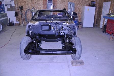

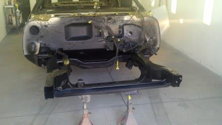

Here are some pictures of today's activity. Torsion bars and front suspension all installed today. The car is back on all four wheels. We will soon remove the rear axle (for the last time) to take it all apart, clean, and repaint it. Check our Facebook site for future updates/additional info. https://www.facebook.com/PerfectShapeCustoms
