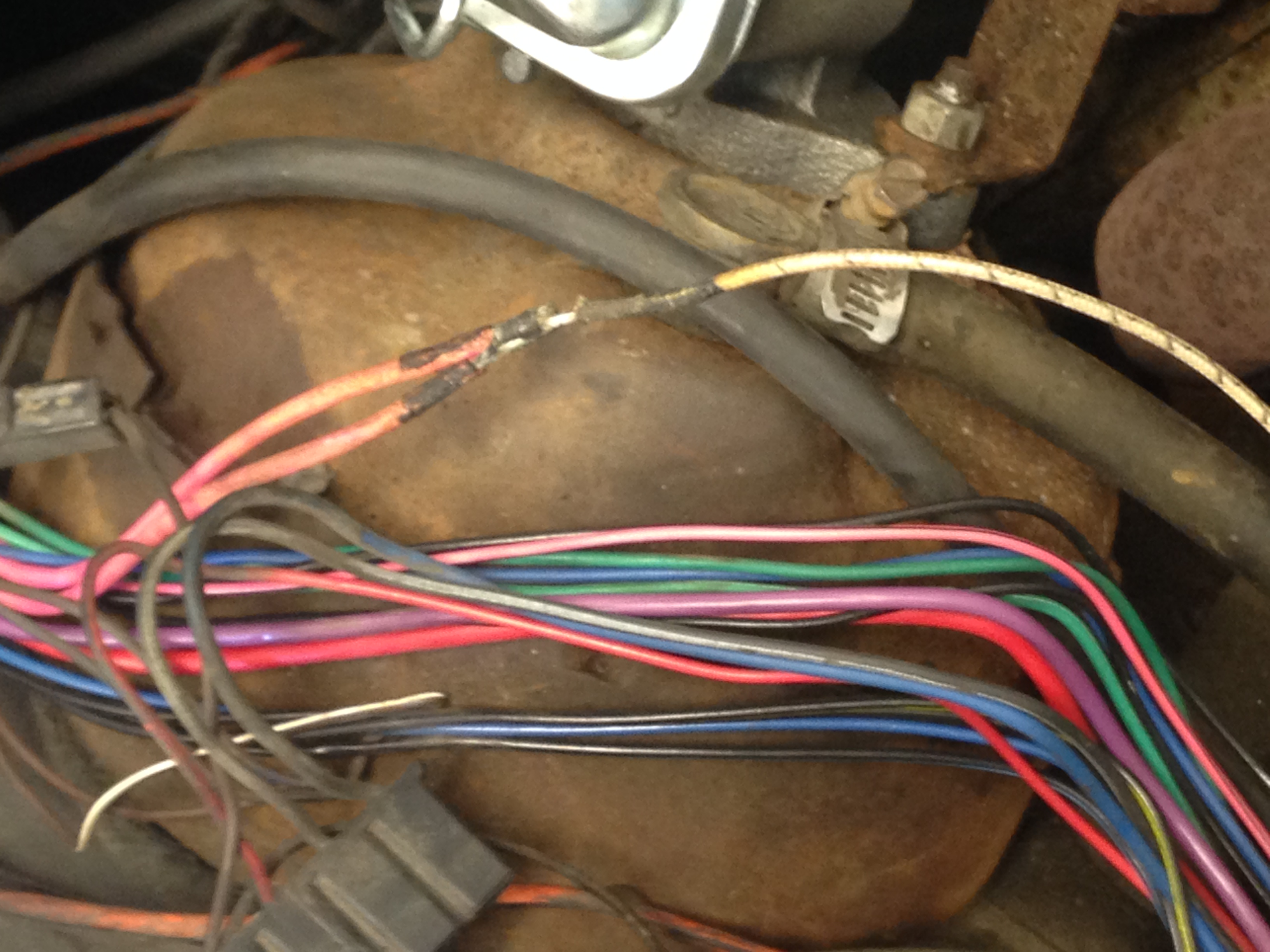

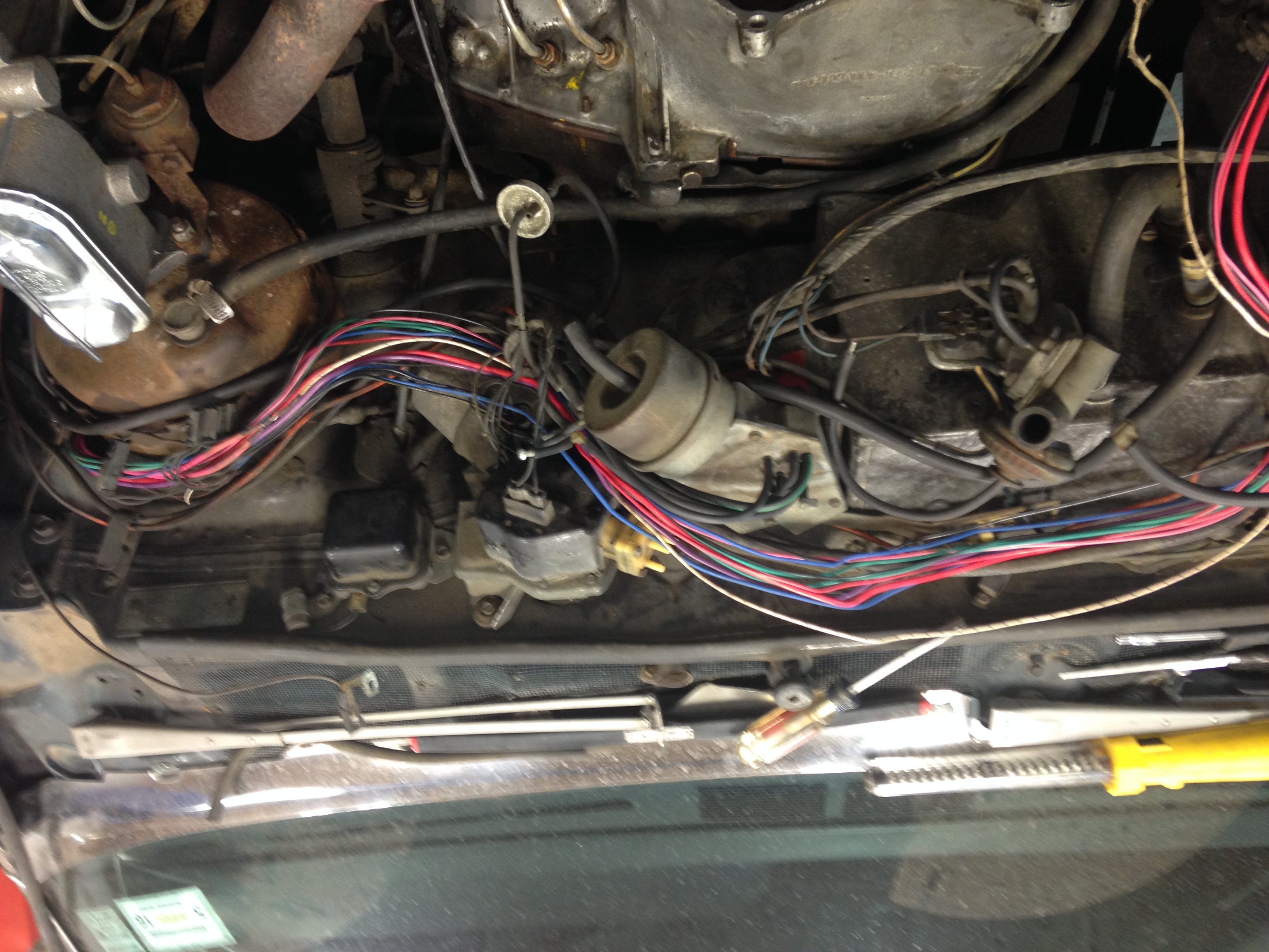

Re: Rsistor Wire
Thanks for the help on this. Peeled back the the tape on the wiring some more and sure as shooting there's the junction between two red hot wires and the resistor wire. Put the ohm meter on it to verify and it was something like 1.6. Far more than zero in any case. I plan to leave the resistor wire there, splice in a length of 12 ga and run that to the coil and tape it all back up. That way if the pertronix fails or I don't like it I can switch back over to points by just switching back to the resistor wire and won't have to undo everything. I should have believed my initial impression the the white wire with little back marking was the resistor wire.
Thanks again on this. Had I not gone back and corrected this error I may well have wound up with a frustrating "no start" situation when I put the motor back in.
