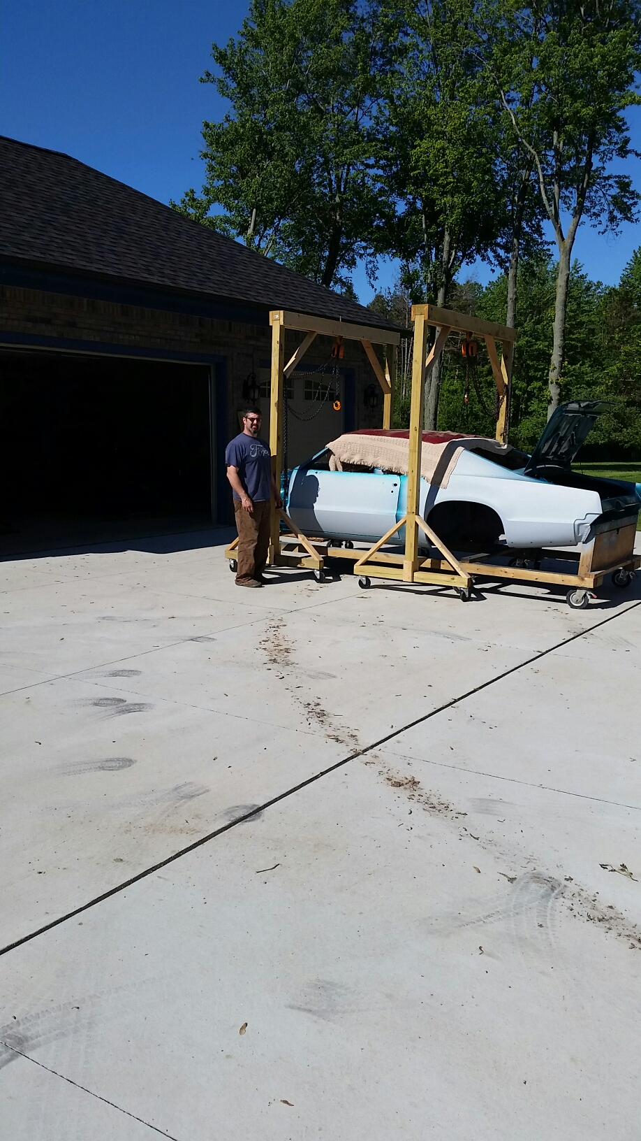

Finally bringing some parts back together...

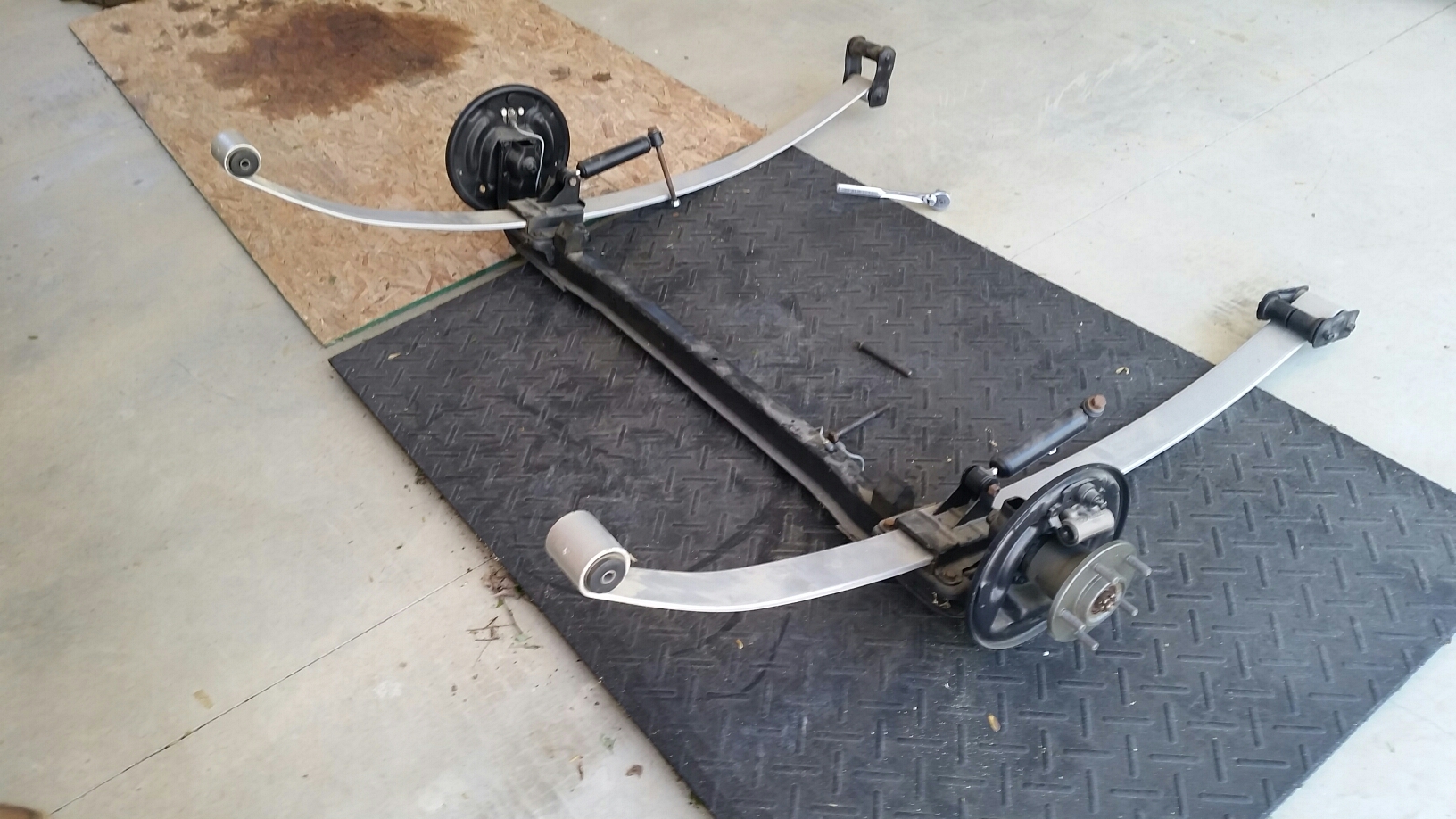

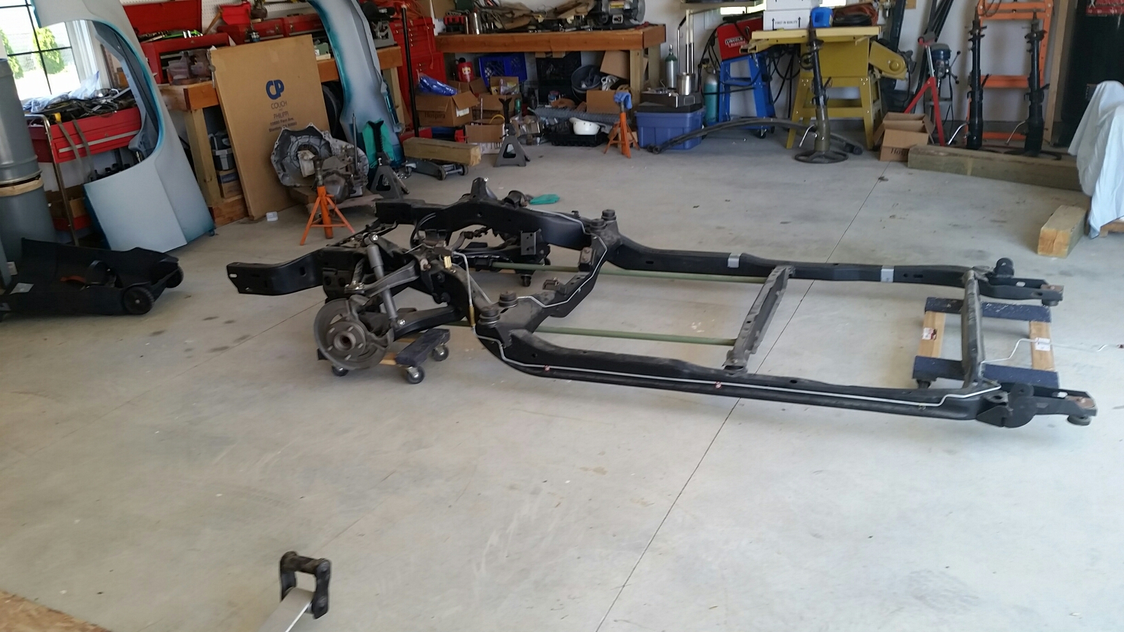

Some of the chassis photos. Can't get the rest, and I have little patience for computer nonsense!

Another...

Did you have the old springs retensioned?

A symmetrical archie pair!
If they're flappy,
It's gettin' air...

Looks great! Still a long road yet, from one that has been there. I noticed your torsion bars are painted the correct color (maybe you just cleaned them carefully). Did you know the rear springs were actually the same color when new? I checked mine very carefully when they were apart and sure enough, same color. Probably same manufacturer.
