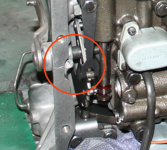

it's been a while..... the Toronado is in its winter sleep and I work on the '56 Caddy. When last looking under the Toronado I saw some automatic gear oil. Seems to come from the manual lever seal. That one has a story with me. When the tranny was on the bench I replaced every seal except the manual lever's O-ring. That was because the pin securing the shaft is buried in the hole. That pin secures the shaft in place, goes through the housing and sits in a groove of the shaft.
At the time I had that in front of me I thought ok let's try it.... it held 2 years, now the long winter rest has oil comming out of the shafts bore..
Did anyone have similar trouble?

The problem is that the shaft comes outwards and the frame is 1/2" from it... Perhaps you can unbolt the motor mounts and allow the engine/trans to drop a bit.

guys you misunderstood me..
I know that I have to replace the shaft's o-ring.... problem is that the shafts securing pin has to come out to remove the shaft. And that lovely pin is buried in the aluminium material of the housing see pic
cheers
Harald

I wish I could help you. I rebuilt my TH425 (and a couple of TH400s) and I never had a problem getting those out. I just don't remember how they are secured, but I bet if you have a closer look it is much easier than it looks.

I am doing my research to attempt the o ring replace with tranny in car on a 1975 eldorado. Also in process of figuring out how to raise or lower off of the driver side motor mount so that the manual shaft can clear the torsion bar if the engine/tranny is in the car. seems like unbolting the bottom engine mount bolt and hoisting up the engine a bit may be a possible method to sneak out the arm.
Your photos were a great help to encourage my DIY attempt. Also in this video of a GMC motor home tranny ( https://youtu.be/6zteEsiMEFU ) at time 1:54 (one hour and 54 minutes) he gets into the detail of that manual arm, the pin and the nut and the o ring. In the video the pin seems to have 1/4" exposure to grab for removal - in your photos it looks like its sheared off?
Thanks for any other advice!
