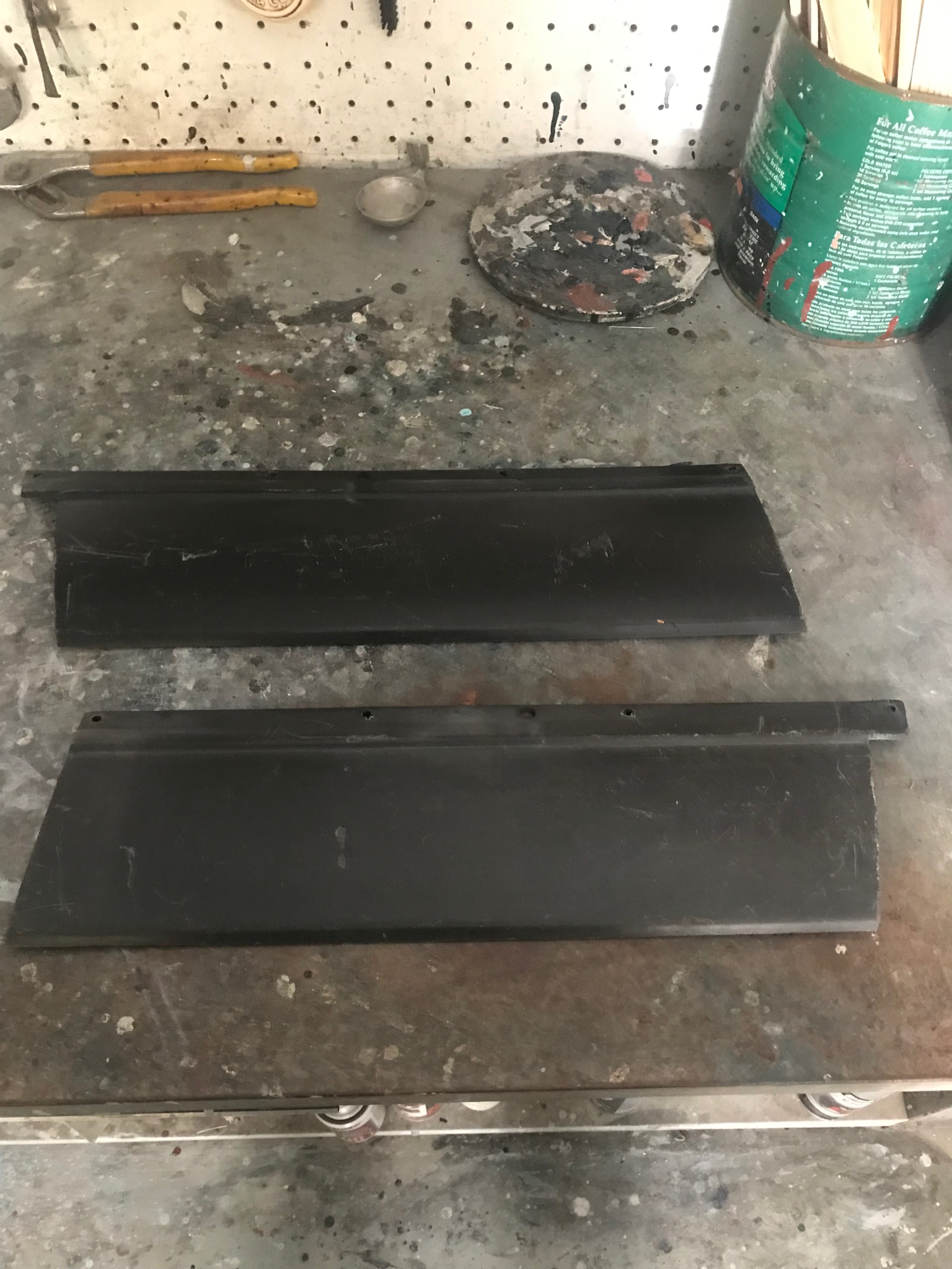

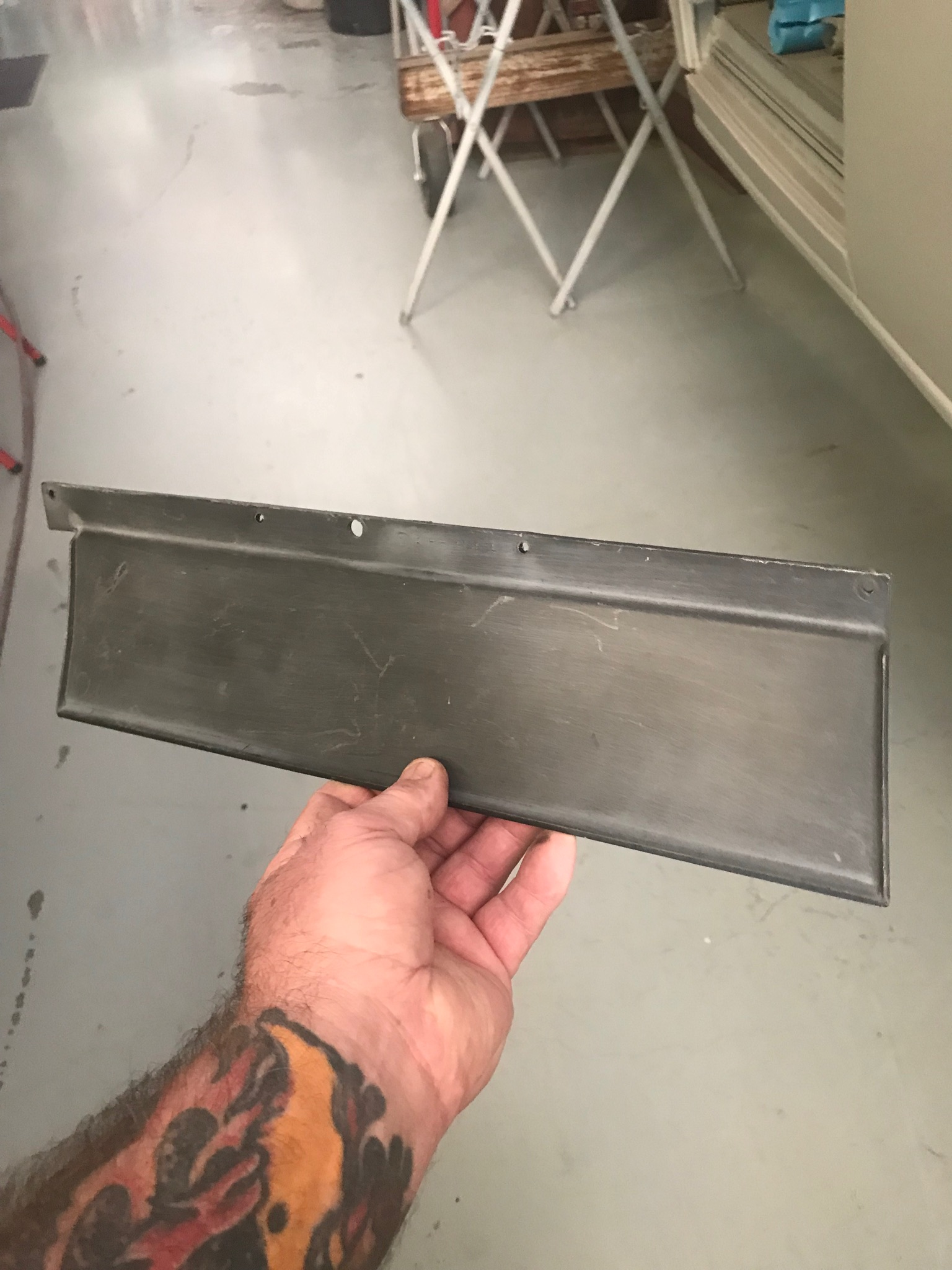

I’ve disassembled this entire car. After cleaning, refurbishing, painting and restoring every part and reassembling everything I almost have it done. It’s taken about 4 years.
I have two plastic pieces that I’ve forgotten where they go. They are obviously a left and right and mounted with rivets. Anyone know what they are?
66Toro Name That Part.

Hi Tuco,
Those are the flaps that protect the headlights when the headlight doors are closed. It keeps debris from flying up from the road and hitting the headlights.
My car has the driver side installed but is missing the passenger side. I was given two good ones by a friend but haven't installed the missing one yet.
Please take pictures or let me know what's involved with installing it. I haven't looked closely but it looks like I might have to remove the grill and/or bumper to access the area.

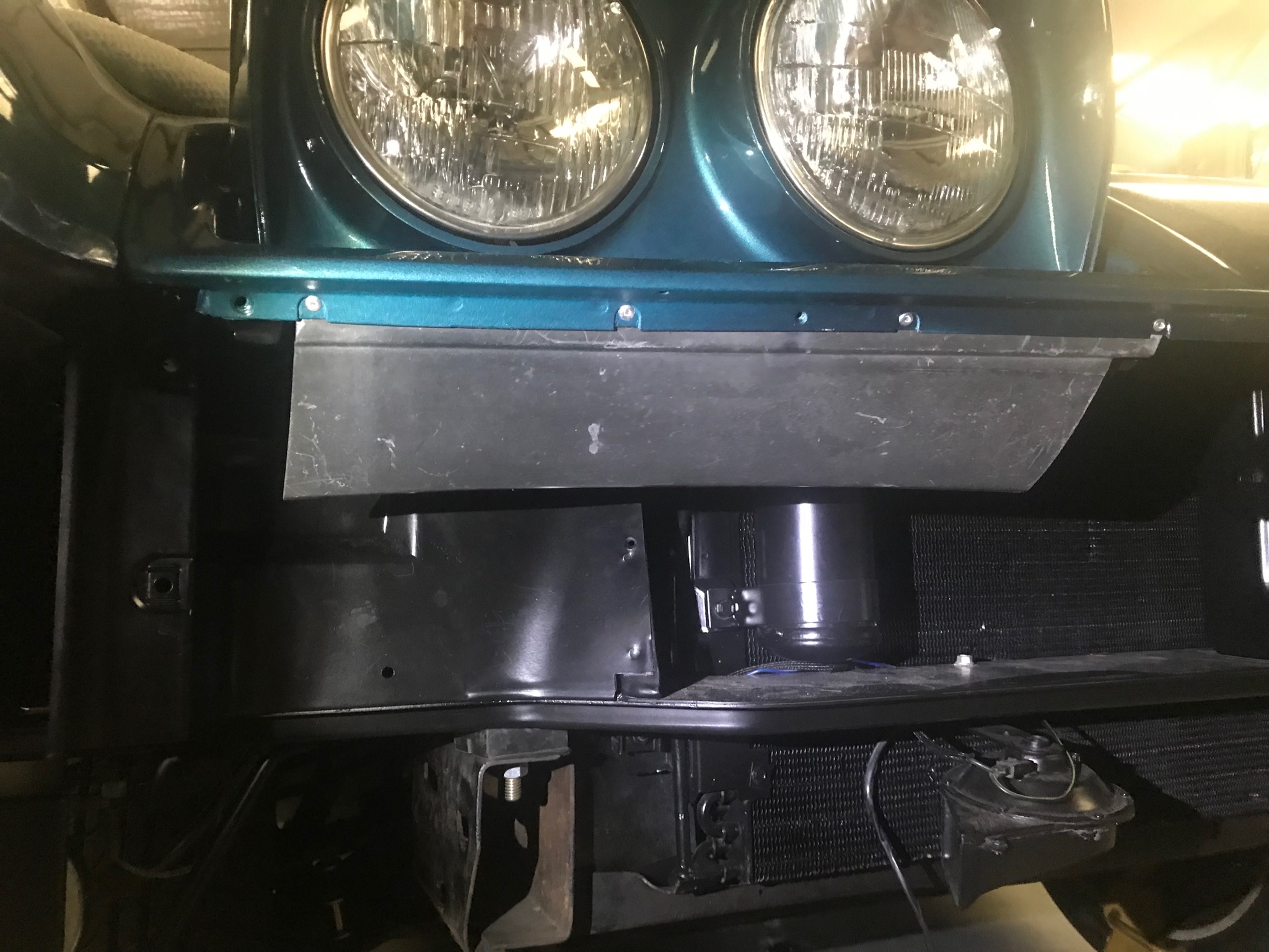

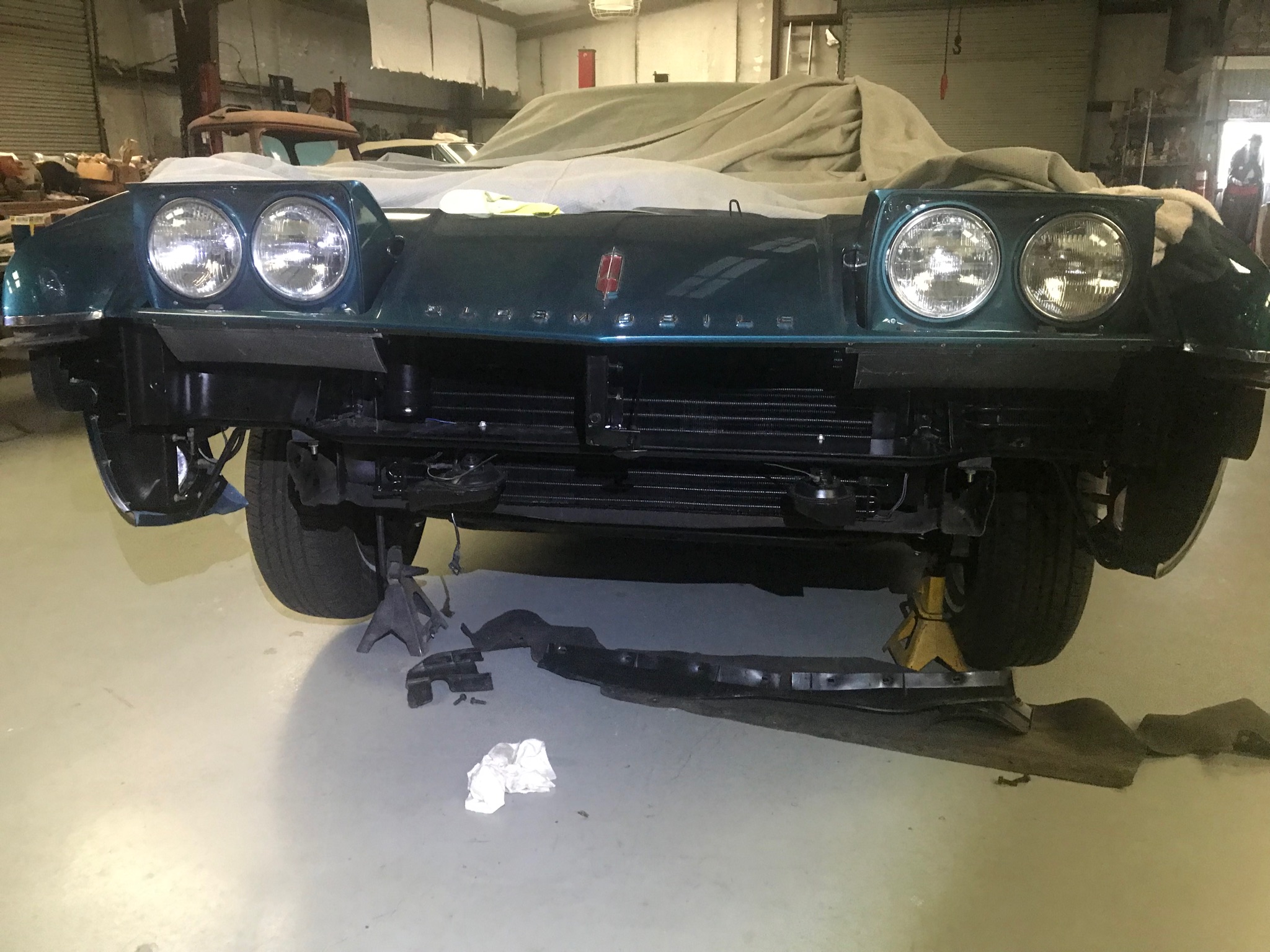

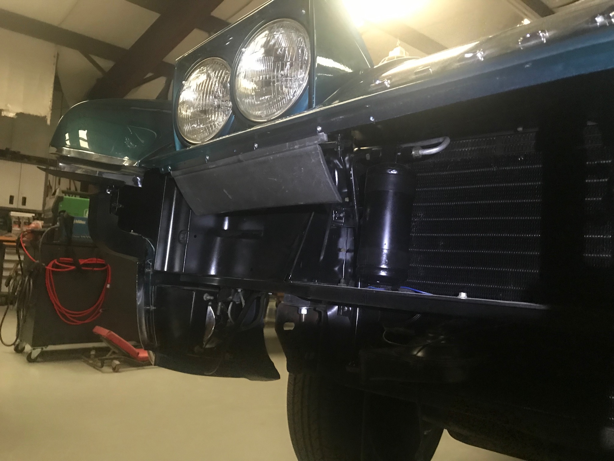

I finally got a day to work on the Toro.
The bumper doesn’t have to be off but I haven’t put mine back on yet so it was easier without it. You do have to remove the grill and the chrome trim vee on the nose panel to gain access to the holes. I installed mine with 1/8 pop rivets with a backing washer.
