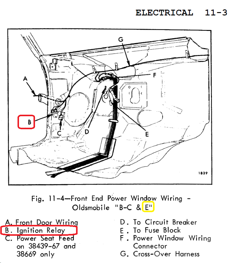

Needing to access, test, and likely replace the power window relay. Where exactly is it, and best way to access it. Kick panels are off. I'm getting conflicting info on which side of the column? I know about what I'm looking for and just can't seem to see it i guess. I'm wanting to rip apart as little as possible and not rebuilding anything. This is a survivor, just wanting to fix it and get it functional.

I don't believe that the windows or seat utilizes relays. Power is transmitted only through the switches

The relay for the power windows should be located here.......drivers side kick panel (from the Fisher Body Manual):

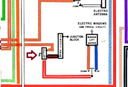

I have also highlighted the relay in the attached wiring diagram from the CSM.
