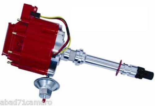

This might be a bit late but I just bought a complete billet HEI distributor for $38 from KMJPerformance on ebay:
http://cgi.ebay.com/ebaymotors/Oldsmobi ... ccessories
It appears to be good quality however I have not yet completed my engine build so have no performance data as yet. I will be glad to report back once I have it operational.
