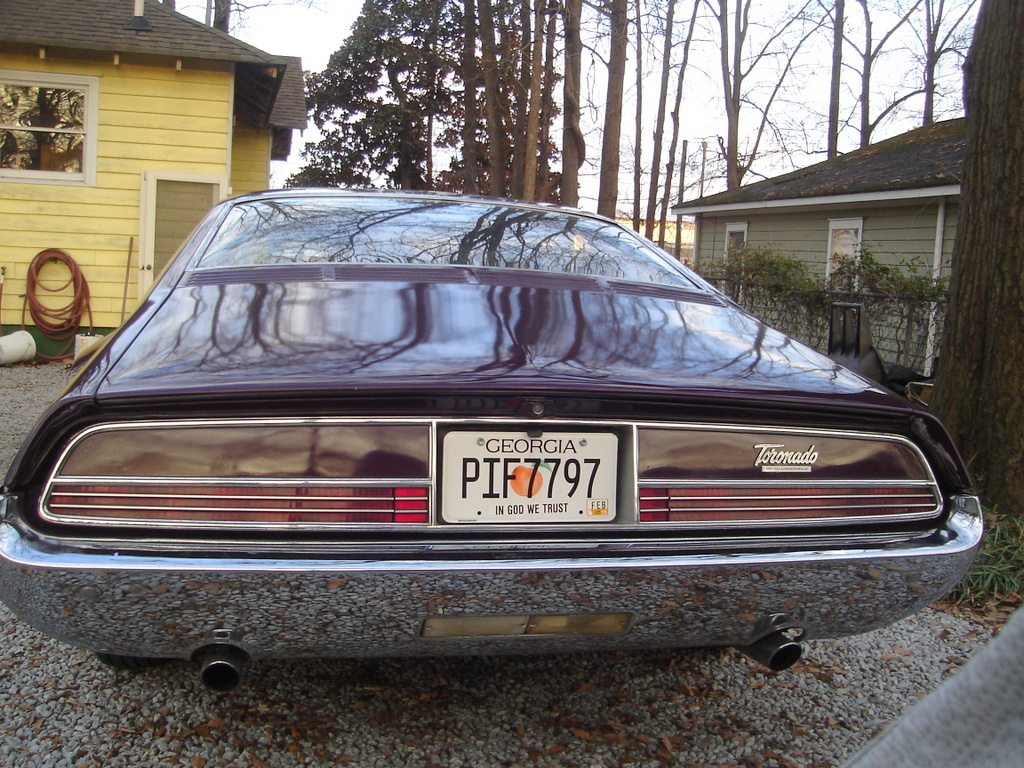

Re: Generation 1 exhaust
Thanks Marty,
I too have been looking at mufflers recently. My original still works but has a slight rust spot developing at the bottom. Probably moisture rusting it from the inside out.
I checked with Waldron as you did and said hell no to a $279 muffler!
So Walker's muffler is an oval shape instead of round? I may just buy one and keep it on the shelf until I need it.
I still have my original resonators and tailpipe tips on the car. They would have to be cut off and re-welded back on.
Otto Skorzeny wrote:Thanks Marty,
Looks beautiful!
