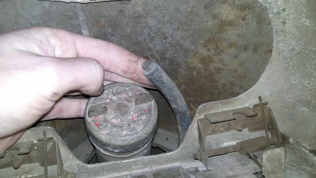

TxGr8White wrote:G66 Super Lift Rear - basically air-adjustable shocks. I think GABRIEL still makes these. The filler tube is at the rear license plate (next to the fuel vent tubes - if your car has A/C)
It's not this is it?
