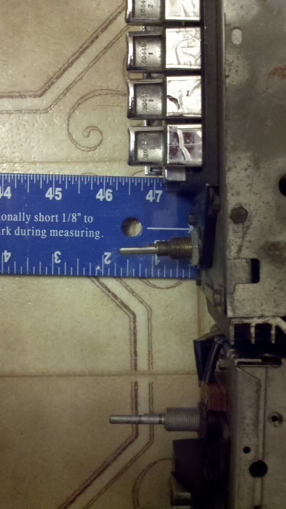

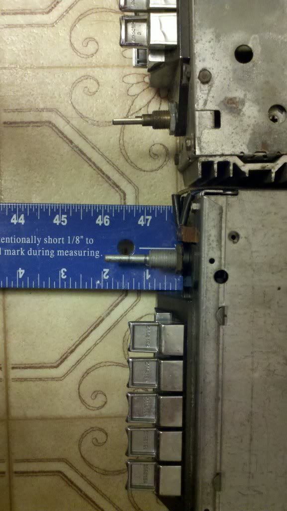

It's supposed to have come from a '66-7 Toro... I had already compared the two, and the AM is definitely longer than the Wonderbar. So he sent me the wrong radio.... Well, conveniently there is one on eBay at the moment I can pick up if I have to.

Well... it's supposed to be out of a '67.... But the shafts are definitely different lengths... Thankfully he has one directly from a '66 as well, and he will check lengths for me. Here it is next to my old AM-only... AM on the right, Wonderbar on the left.

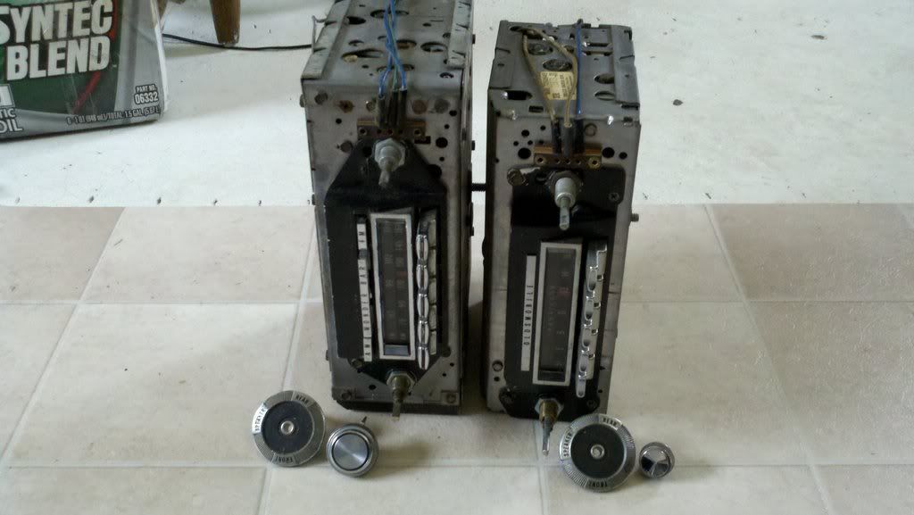

Ok ...just for grins stack the radios and take a picture so we can see the fronts Oh one last question were the knobs with the wonderbar? If so show them as well.
Posts: 473
TOA Membership Number: 839
Re: Retrofitting Wonderbar into non-wonderbar '66
Postby Twilight Fenrir » Sun May 08, 2011 7:07 am
69W34 wrote:Ok ...just for grins stack the radios and take a picture so we can see the fronts Oh one last question were the knobs with the wonderbar? If so show them as well.
Well, the studs on it makes it difficult to stack, so I set them side by side instead :P
It did come with the knobs shown, but I knew the main knob was not original. The back disc-knobs were identical to my AM's.

Postby 69W34 » Sun May 08, 2011 7:53 am
Ok Looking at push buttons and tuner /volume nob of the wonderbar it would appear to be out of a 67 other than the obvious visual appearance (and all things being equal) there would be no reason not the use 67 nobs.

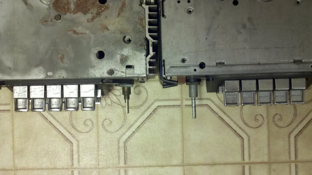

My original AM knobs should be the same as the 66 wonderbar knobs by the looks of it. He double-checked, and the '66 one he has on hand does have the 2" shaft-length. So he's sending it to me, and I get to piece together what I need to make it work, and send him back whatever is left over.
