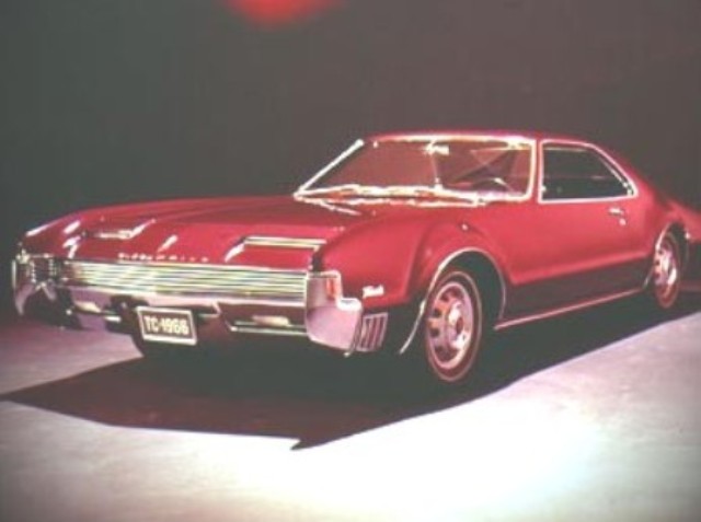

if you look at original marketing photos, it can be seen that the eyebrow panel is flat black surrounded by chrome on the raised edge. Unfortunately ours was painted over too during repaint. We put them back to black, but I would like that chrome edge.

Re: 66 Toro Eyebrows -- Black or Chrome?
Here's a great photo from an advertisement that really shows a great look at how it was done...
Hopefully that helps some more!
