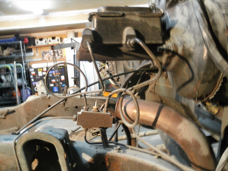

Would any of you know if I can keep my drum brake adjustment valve as seen below?
I have fit tested my 69 disc brake booster, master and metering valve combo. All the brake lines line up perfect. They both use the same distribution block.
Yet Another Disc Brake Question

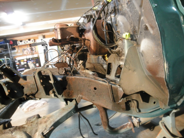

Here is a pix of the 68 drum brake set up

Here is the 69 disc set up. Notice how all the brake lines all line up. If i can keep the drum brake adjustment valve. I'm pretty much set.

I am not completely certain but it seems reasonable to think that the boosters are pretty much the same. As for the rear adjustment valve I am pretty certain you will need to use the version for disk brakes as there is a difference in the proportioning between drum and disk front brakes.
I did not do a drum to disk conversion so it is not my area of expertise, my comments come from a general knowledge of how braking systems work. Specifics may vary from situation to situation, so it would be wise to mimic the disk brake setup when you convert; that means the valve probably needs to be replaced with whatever is on the disk brake setup.

I thought there could be a difference from drum to disk. However I cannot seem to find any markings or stampings on the valve. Which makes one wonder: how in the heck could they keep things straight during assembly!
