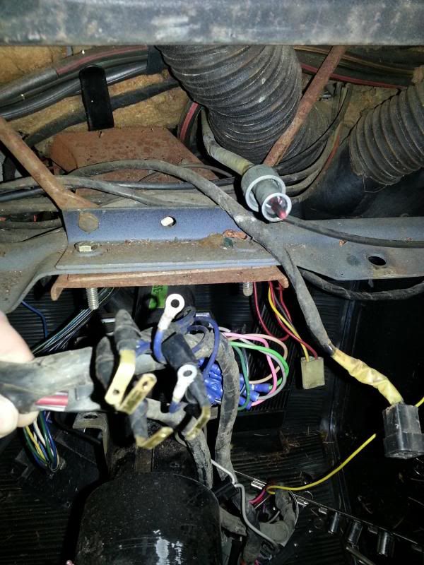

While I was taking the connectors off the dash, a few of the pins came with the connector (maybe that is why the gauges were not working?) Any suggestions? Is there some outfit that sells some sort of new crimp on pins or something? I thought about putting a very fine screw or something in there but I'm not sure that will work with the connector.

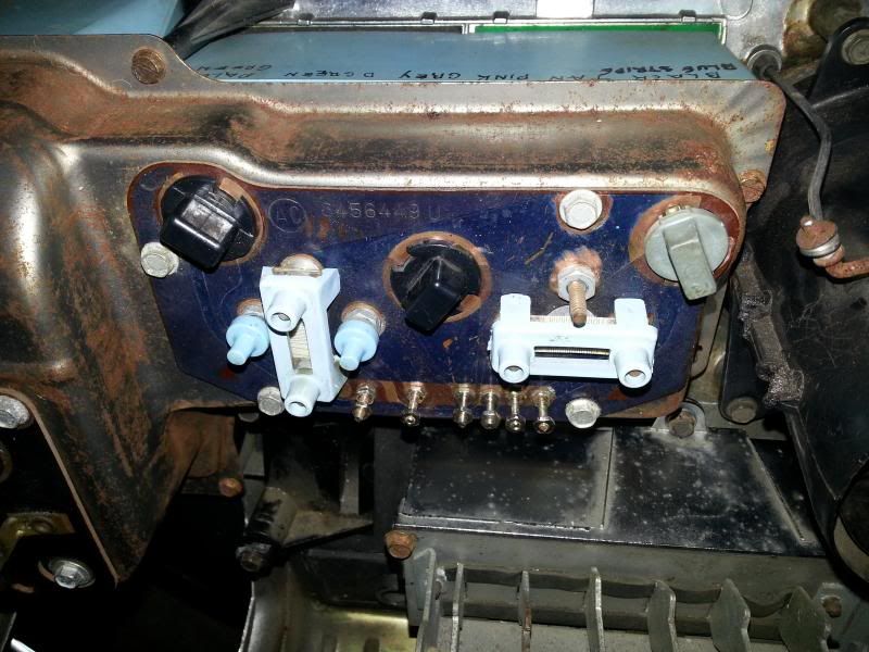

I took the heater controls apart and after some tapping and banging the vacuum valve moves properly allowing all of the buttons to work as they should….hopefully the valve works without leaking!

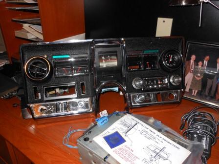

- The Comfortron unit is out on the dash to finish up a few items before reinstall. The Cruise Control wheel is also out -- have to fix the linkage. The bezels at the bottom are off until I get the correct font to have the trophy shop engrave them on the aluminum panels. The clock has been converted to quartz movement, and the Wonderbar has been completely serviced. All circuits were bench tested. New felt for the air vent, Comfortron, Cruise Dial have been obtained and fitted.

That's a good looking dash! I don't know if I am going to take the time to strip and repaint mine right this second but I might have to after seeing that. I will try to take some pictures of mine later today and post them.

Someone along the line has done a little rework. The circuit board that has the fuel/temp gauges on it no longer has any pins. They have been replaced by tiny screws, presumably because the pins broke off when they were removing the dash. They cut the connector out of the wiring harness and replaced it with what looks to be some small "L" shaped pieces of brass that gets secured to the screw with a little nut.
I'm not really a fan of this because if one of the nuts comes loose the little "Ls" have the potential to touch each other.
What I would really like to do is replace the circuit board and connector. I have an inquiry out to someone who has a couple parts cars on Craigslist but haven't heard back. Does anyone our here happen to have a couple circuit boards and a connector in good shape?
My other problem is that when I was taking the dash out, one of the pins on the circuit board for the oil/amp gauges stayed in the connector. The pins look like they are maybe pressed into the board and get secured by 4 tabs that get bent over. Age, vibrations, and gorilla man-handling look to have taken their tolls on the pins causing some of the tabs to break off making the pins loose and more susceptible to failure. You say you have soldered these? To what? The copper traces?
