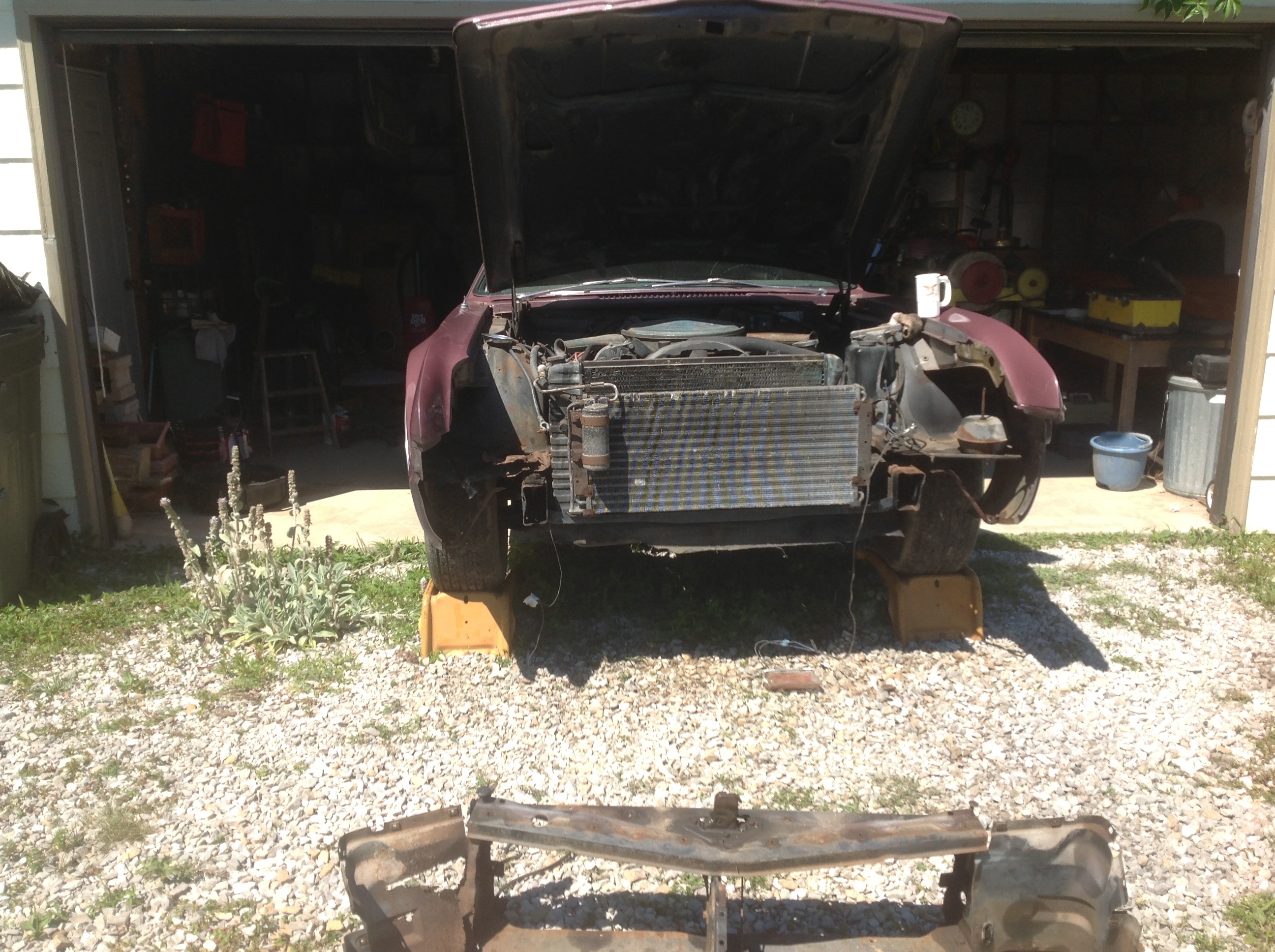

Well men,
Thanks for your advice. I used the resources online and some of your advice and a lot of just shaking it and looking for the hidden bolts and got the radiator support removed.
Now I must find a replacement. I'm going to check with a machine shop and then off on a 2 hour drive to a supposedly complete 67 Toro for 500 dollars....keeping my fingers crossed its not completely rusted out.
"Checkov"
"Checkov"

Re: Best book to buy that explains how to work on a 66 Toron
Looks like the battery corroded part of that away, but the center and left section are probably fine. If you can get a good one off a parts car, you're in luck, although many are similiar condition to this one I bet.
