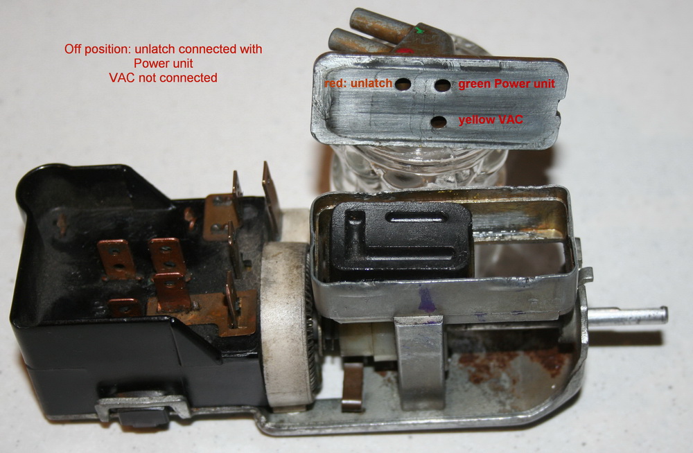

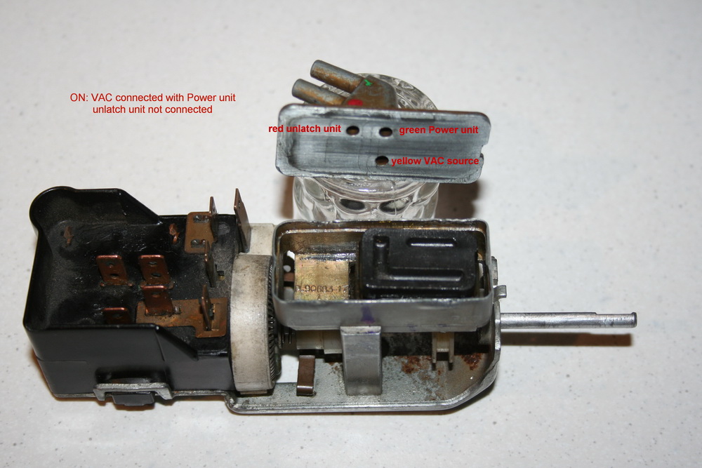

Here is what I found out:
Switch Off

Postby harascho » Sun Feb 08, 2015 12:36 pm
Switch in ON position

Here's the situation when you switch the headlights OFF, the VAC source is isolated and the power unit connected to the unlatch unit, The VAC in the big canisters overcomes the springs in the unlatch units and they open for some seconds, enough to unlatch the actuating rods. But then where is the bleeding possibiity to unload the VAC in the power units completly.. I don't see it must be an Oldsmobile engineering flaw of the sixties..
