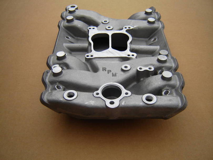

That intake manifold will not fit under your hood unless the throttle body is substantially shorter - which is may be. I would check it out.

Why not use the Rockwell intake sold by Mondello? See links below pic...
http://www.bdub.net/grockwell/
http://www.mondellotwister.com/

There is a very significant difference - the 4150 is a standard style intake. Our Toros have a sunken intake to provide hood clearance. Any non-Toro intake will require hood mods. This is universally true.
What kind of racing are you intending? Presumably not drag racing as the FWD does not lend itself to strong launches...
BTW I went with the Edelbrock heads and they are very nice indeed! Be sure to get a new set of Head Bolts (ARP 3600)
http://www.summitracing.com/parts/ARP-180-3600/
Also upgrade to HEI ignition. Let me know if you need more info on this.
