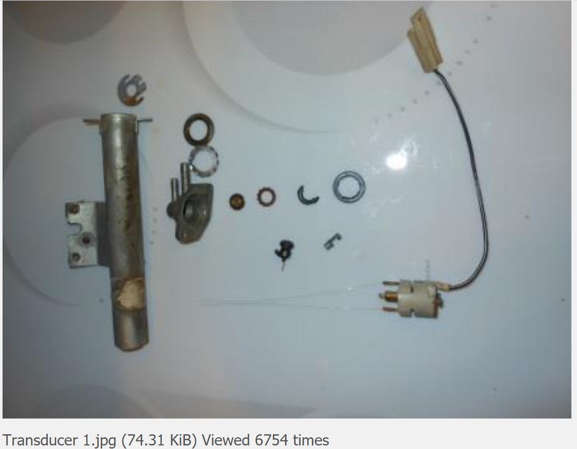

About the transducer: It resembles a tube as in the picture below: It would be on the passenger side affixed laterally on the upper part of the floor (screwed into the carpet) below the glove box. I'm pretty sure you should be able to find it by lying down on the floor. It's sometimes a source of problems, and I want to make sure you have one. See the picture or check out this link: http://www.toronado.org/forum/viewtopic.php?t=1499
